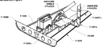

I installed the Vans OP-48 AHRS bracket (VA-260). With a piece of angle on each side you can mount a transponder and/or remote com. Unfortunately, it looks as though it may be unavailable on their website but it might be worth asking.
Another option would be the strobe and ELT brackets F-10112-L and -R which could support a txpr or com.

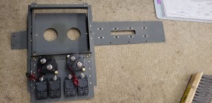

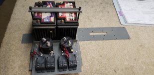

I modified the standard battery mount to accommodate two PC-625 batteries (I’d guess these are about the same footprint as your EarthX). I used some 0.063” sheet from the trim kit to make a side tray for both master solenoids and the four, 30amp relays that provide separate feeds to the panel. Some bending of aluminum to shape is required.
Also mounted in the area is the ELT on the starboard side and the ADS-b receiver on the port side. Both of those are mounted on 0.032” aluminum trays with the ends bent to make a Z shape. These tray “feet” are pro-sealed to the bottom fuselage skin and the trays have nut plates for the component mounting.
I mount my remote Comm #2 and remote XPDR on the bulkhead forward of the panel (a lot of room to mount such stuff). I suggest mounting them aft as you discuss to be much more work for wire runs and such.
