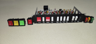

After almost 24 years of service, the plastic rocker portion of the (red) avionics switch cracked. I removed the switch and determined it was manufactured by C&K. I was able to build a P/N for this unit using the internet literature, but have learnedthe part is obsolete. I have been unable to locate any residual stock. Has anyone been able to find this part or a drop-in replacement for this part (P/N CA22J73207PQ)? See photos, below.

I mentioned somewhere that I would report back on my tests regarding switches from Amazon that MIGHT fit the ExpBuss II.
The large switches fit width-wise but will need a mm or two shaved off length-wise (height). The hole is a bit too tight for the existing switch as I had a very hard time removing it to check.
The smaller switches seem to fit just fine. Note that the right-most switch is unlit black. I could not find any unlit white. All of the other switches noted here are lighted.

JD 2pcs 30A Power Switch. Amazon has all of them. The red master switch is a 4 pole instead of the 6 pole it came with. The extra 2 poles were not used in my set up.​
Yes. "What he said." The lighted ones are what I ended up getting of the larger switch.
I see that this one:
JD 2pcs 30A 125V/250V AC Boat Rocker Switch ON/Off Switch 4Pins Toggle Switch with UL Certificate Waterproof switches(Red 4pis)​
seems to be little shorter by just about the amount needed and is NOT LIGHTED.
These are the small ones with color (and lighted) that I got:
Twidec/6Pcs Rocker Switch 3 Pins 2 Position ON/Off AC 20A 125V 15A 250V SPST Yellow, Red and Green LED Light Illuminated Boat Rocker Switch Toggle KCD3-101N-YGR
And these are the black ones:
VEXUNGA 10pcs KCD3 Rocker Switch 2 Pin On Off SPST Boat Rocker Switch 20A 125V 15A 250V AC 2 Position Mini Black Rectangle Toggle Switches for Car Marine
