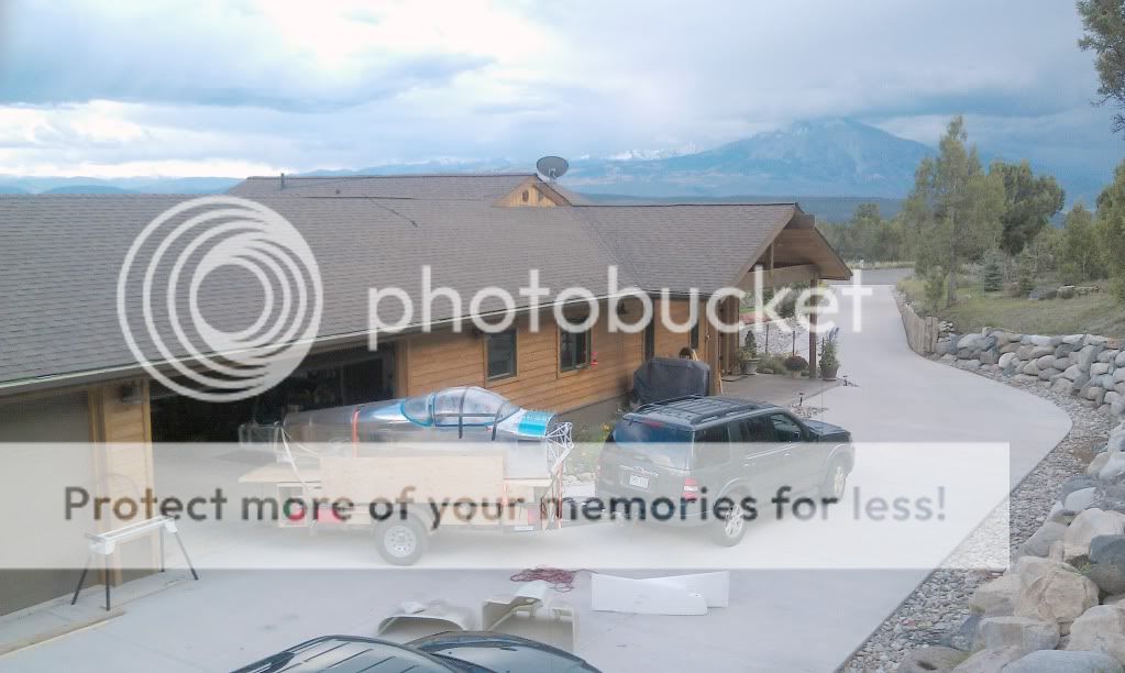

This is a 5'x10' trailer and has the complete airframe including wings and empenage.
