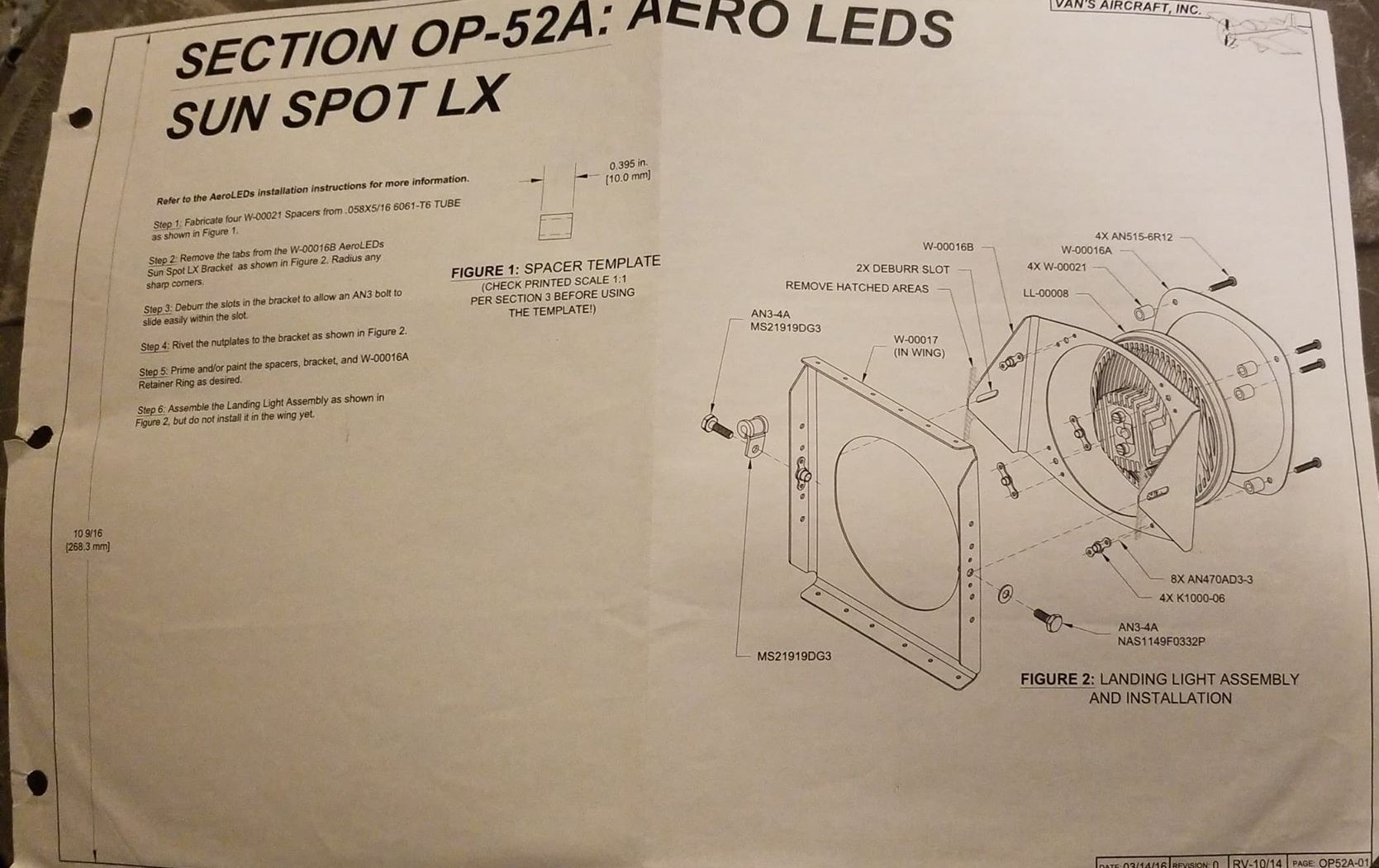

Keith. What landing lights did you go with specifically from Aero LEDs?
Are they AeroLED Sunspot LX Landing light listed here on Van's site?
https://shop.vansaircraft.com/cgi-b...638-408-624&browse=lighting&product=LX_RV-14-.
I'm going this route or with Flyleds.
I purchased my landing lights in 2016. The description on the installation instructions is Sunspot 36LX. (It's possible there has been a product update as this field is changing rapidly, but they only get better).

Hey all,
I am going to use fly leds and omitted lighting from my wing order. Do the par 36 mounting brackets come with the wing kit? If not, how do I order them? I called vans and they didn?t seem to know what I was talking about..
Thanks!
Hey all,
I am going to use fly leds and omitted lighting from my wing order. Do the par 36 mounting brackets come with the wing kit? If not, how do I order them? I called vans and they didn’t seem to know what I was talking about..
Thanks!
There is a landing light sub kit with a separate plans section number. You need to order the kit and delete the lights themselves from the kit to get all of the PAR36 brackets and hardware. You want section OP-52A "Sunspot Light kit" and delete the bulbs.
Without having done this myself I don't think there's any value in ordering any of the parts in OP-52A.
The main bracket already comes with the wings. I think it would be a simple job to fabricate some angle and/or forwards adjustment brackets to hold either of the Flyleds lights.
