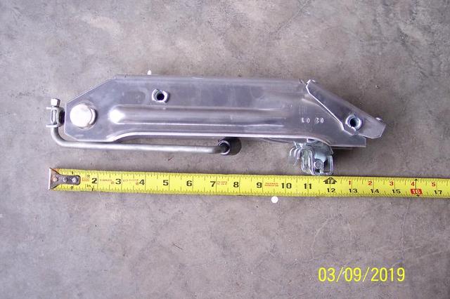

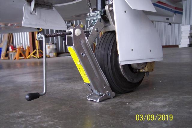

I wanted a quick ,light way to jack the wheel for possible flat tires out bush.
While not as elegant as the previous post,I found this to work well and only $3.00 at your local auto store.
I use a bit of tape to protect the powder-coat and with both other wheels chocked,it was very stable to remove the wheel.
The small ratcheting screw driver was added to the fly away kit,because if you do have a flat,there is very little room to get to the lower wheel pant screws.

What's this fitting called? (It looks like a u-bolt with a special bridge.) Just in the regular hardware section of any auto parts store store? I've seen others use 1-2 stainless hose clamps to serve the same purpose but yours seems much more substantial.
Although I currently use a tall jack at the tie down, I'd really like to carry this in my travel pack b/c it can be used anywhere with a regular car jack--plus, no danger of anything slipping off the tie down and poking a hole in my wing.
