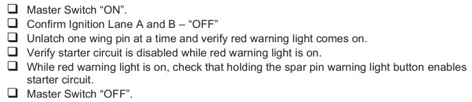

As I work my way through PAP on the 12iS, some weirdness happening on PAP G4-2, enabling the starter circuit.
Red warning light comes on on spar pin removal. Cool.
Starter circuit is apparently disabled while red warning light is on. Also cool.
Pushing red light does not override starter circuit. Not cool. Not cool at all.
Putting the wing pin back in with red light off also does not result in an engaged -- or even a "let's just move in together" -- result.
Obviously a problem with the starter circuit.
Curiously, I get a red X over the oil pressure indicator on the G3X with Lane B on. That strikes me as new. It has me wondering if these are two different issues or connected in some way?
Seems to me, the next logical step is to complete SL-0072 (I already had the part on order) and retry.
Status: Cowling off. Air probe at filter disconnected. Spark plugs removed.
