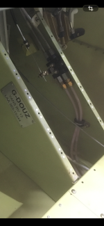

Is the RV-12is parking brake available for retrofit on the legacy R-12?
Has anyone done it?
For me it would be a very welcome upgrade.

There are several threads on legacy RV-12's with the Matco Parking Brake Valve. Not a kit from Van's, but its' fairly easy to splice the valve in the existing brake lines. There are a couple of locations you can use and you have to come up with an on/off method (cable or level).
