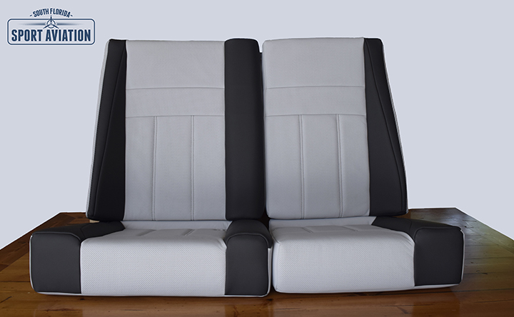

Classic Aero RV-7/9 Slider -Aviator Seats- (LEATHER vs ULTRALEATHER/Synthetic) Pros & Cons of both. Price is just about the same.
- Ease of upkeep?
- Durability?
- Breathability?
- Ability to dry if gets wet (opening canopy etc)?
- Heat after sitting in the summer sun?
- Cold after sitting in the winter shade?
- Look (We know real leather smells better)?
Getting ready to order in a few days and would appreciate your review of what you may have/use or what you would like to have and why.

Thanks, I do have the samples and made a choice of color, just trying do decide on Leather vs UltraLeather. We have UltraLeather in our Airstream Camper and love it, and Leather in the car. Big concern is in more direct sunlight how will the heat be. My design is black on the perimeter and a very light grey on the interior of the seat.

Go With Leather!
I have the ultraleather in my RV-7A and now wish that I had gone with the leather. The ultraleather is deteriorating at the top of both seat backs and has an open cut in at least one place. I talked to Classic Aero and they said I would have to send the seatbacks to them to have the fabric replaced. It would be too much downtime for me so I decided to live with it. I'm not too happy after spending over $4000 for the whole interior. I have been flying the aircraft for 8 years.
