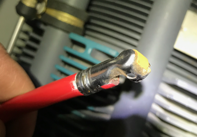

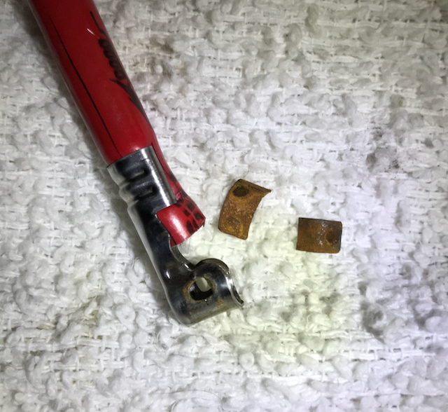

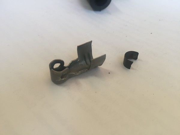

I had a similar issue. The tiny spring steel half circle clip on the end of the spark plug wire that holds the electrode was broken.
It is the piece on the right.
I found a new one at West Marine, and got it installed on the existing plug wire. I had to destroy the boot to access it. I got a replacement boot from E-mag.
I did the same inflight mag check and it pointed to Cylinder #1 and the top sparkplug. I knew something was wrong when the engine would just burble a bit here and there. Temps on the #1 cylinder were just a bit out of line from previous experiences. Only real indication was that the clip didn't feel tight on the end of the sparkplug, but with the rubber boot, it was difficult to really see what was going on until I cut off the boot.

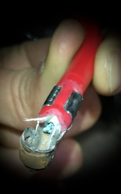

By the way, upon inspection, I found in each of my cylinder 2 and 3 wires, one half of those of those clips as in Bruce’s post above. They were broken, very rusty and corroded, and falling out. Seems like this harness is toast.
I’m still not sure my resistance data could even be valid. I did make sure I had solid connections, correct voltmeter settings, etc.

Here's an additional update - after seeing those broken clips, I started pulling terminal boots off. Here are some photos of the three that I pulled. Looks like every one of my terminals is bearing a striking resemblance to Bruce's. After that I decided to just purchase new harnesses...
I also just got done putting an ohm meter to every ignition wire and the results I got were rather shocking. So much so that I don’t know if this is actually possible. Two wires showed good resistance. ALL of the others showed open loops or nearly so. Could the engine have even run if this data is valid? Maybe my ohm meter couldn’t complete the circuit, but the thousands of volts the P-Mags are sending could get the job done (barely)? Is that possible?
Yes. Your spark jumps an .035" gap on every event. However, this stack up of resistance will greatly decrease spark energy, so no suprise that there wasn't enough energy to consistently lit a lean mixture (They are harder to light than richer mixtures).
A good lesson for us all. Modern electronic ignitions will fire plugs, even with bad plugs and wires, up to the point where things go south. Check the wires and plugs at every annual.

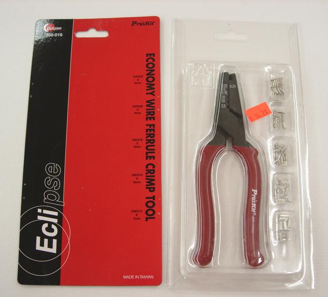

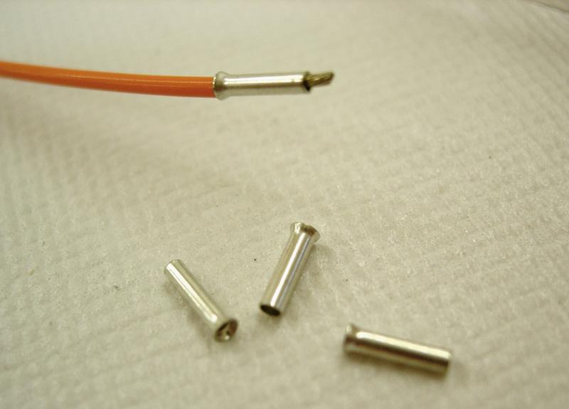

I bought a roll of spark plug wire, terminals and crimp tools from Summit Racing for DIY cables to fix some exhaust-burned plug wires on my Rocket. Cores were exposed, discovered at annual. Engine ran fine, but I’m glad I caught it.

I finally got to fly the plane with new terminal clips on the end of each wire. I bought 8 of them from Napa. For future reference the P-Mag wires are the 7 mm type (hard to find that data anywhere). I replaced each clip on each wire and all were then within resistance specs with solid connections all around.

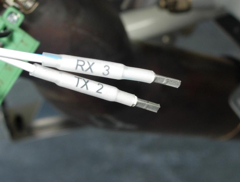

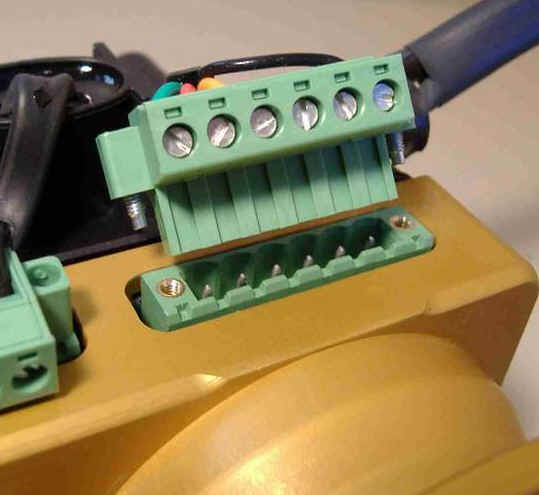

Strange, this diagram seems to indicate that it's blasting out data on the rs-232 all the time.
Savvy seems to support the UBG-16: https://resources.savvyaviation.com/monitor-specific-faqs/
You're right but the "black box" Stan is referring to is the MUX-8. I don't think I have one of those. Without one of those, the data from the UBG is unobtainable/lost/unusable... (?)
Looks like this serial data connection feeds the black box, and it makes it a bit easier to read. But I think you can get the data from that connection - my guess is it streams so you would need something to read that data in real time - like a laptop or an arduino or a raspberry pi or some other small device that can listen on RS232 at 9600 baud.
Another option is to buy the mux-8, but I personally would use that 300 towards installing a better engine monitor system like a GRT EIS 4000 with one of their EFIS systems.

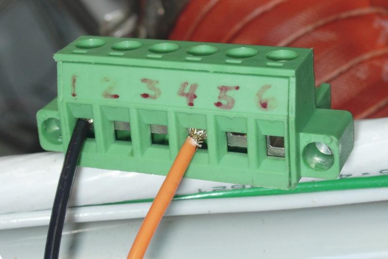

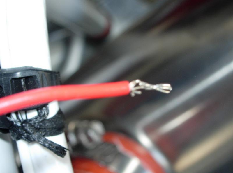

Yesterday I went to go fly and the engine ran extremely rough on the ground. So much so that I turned around and returned to parking. The only time I’ve ever done that with this plane. Felt that same rhythmic stumble but rather amplified. Experimenting in front of the hangar, I tested each mag individually. On the left, the engine eventually coughed and died!
I was fully about to finally remove both mags in desperation and send them in to E Mag Air for bench testing as they suggested I do next on the phone.
Uncowled it, discovered what you see in the picture. Left mag ground had become disconnected. The screw backed out.
I took the opportunity to troubleshoot my tach issue as well. E Mag Air suggested I run it withe either tach wire disconnected, one then the other. No progress. The tach was still intermittent on both wires individually. Weird.
However, when I put everything back together it shocked me how loose each terminal screw had become on the mag connectors. I decided to say screw it and cranked them down WAY more than the installation manual spec recommends. Put everything together and... Voila! Started on the first blade, no stumbling on the ground, tach issues were completely solved, ran smoother than I’ve ever felt it before, no problem running deep LOP. In-flight LOP mag check passed with flying colors...
I’m skeptical that all these problems could have been caused by (barely) “loose” wires, considering they were torqued to factory specs but I’m hopeful the issue is solved. Strange lesson learned on this one...
Definitely not counting my chickens yet. I’ll update if anything changes but 5 hours later, so far so good.
