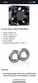

Better yet, I purchased an inexpensive computer tower cooling fan and an inexpensive programmable timer and made a flat piece of fiberglass the size of the oil door opening (with notches dremeled where the hinges come through the opening). Used the dremel to cut the correct airflow opening in the fiberglass piece and wired it with a connector that fits my battery tender connection.
In the summer I put it in place when I get to my destination and set it to suck out hot air from under the cowling for 30 minutes.
The oil door cannot close when this is sitting on the opening.
