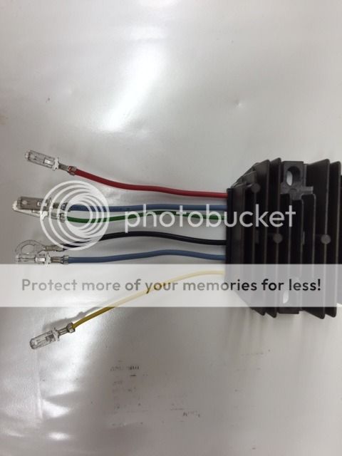

Well, my Ducati regulator bit the dust. I purchased a John Deere regulator part number MIA881279 (I read here on the list this replaced part number AM101406).
The new regulator came yesterday, and there are absolutely no markings anywhere on the unit labeling the wires. No letters, words, symbols...nada...
Randy's post on 8/13 with pics was great, but my JD regulator is totally different than his. (maybe his is the AME101406?)
Has anyone used this unit? If so, can you help with the wiring please??
Here is a pic of the new unit. (The Ducati's wires are labeled G,G,R,B,L,C)
Any help would be greatly appreciated!

Permanent magnet alternators (dynamos) do not have a field winding and thus no "F" terminal. The "C" terminal on the Ducati regulator serves a dual purpose: it is an on-off control and also bus-voltage sense. The regulator monitors the voltage on the small yellow wire that comes from the master switch. The Ducati regulator adjusts its output to maintain a system voltage of about 13.8 or so, at least on my plane.
The John Deere AM101406 and MIA881279 terminal "IGW" corresponds to the "C" terminal of the Ducati. I have not installed a John Deere regulator on my RV-12 because the Ducati has not failed . . . yet. But I did replace the regulator on my Simplicity lawn more with a John Deere and its output is 14.2 volts, which is higher than the Ducati. Most aircraft and automotive regulators are set at 14.2 volts.

I had seen this post from Joe in my searches, but the problem is the MIA 88129 has NONE of the wires marked to determine which wire is the "IGW" or what any other wire might be...

Can you get something from John Deere identifying each conductor ?
we can figure it out from there.
Search the web for Voltage Regulator and you will get tons of pictures and wiring diagrams. Also, look at the wiring diagram from Van's to determine where all the wires go. I think you can eventually figure it out. The red, black, and blue wires are obvious. I suspect that the yellow wire is the "sense" wire from the alternator, that just leaves the green one.
Tom,
You might want to verify your purchase. I searched both of those part numbers pretty hard on Google and found lots and lots of pictures and none of them look like what is in your picture. All of the pictures that I found have 5-tabs as opposed to the 6-leads that yours has. All of the photos have an identification for what the 5-tabs are, as well. I would question the vendor you purchased it from.
If I were replacing my voltage regulator in my commercial mower, that one in your picture wouldn't work.

Sure worth checking but I did the same search and found these:
https://www.google.com/search?q=MIA...ved=0CAcQ_AUoAmoVChMIxqih3JOHyQIVQaEaCh1-nAyT and https://www.mowerandtractorparts.co...70-f912-f915-mia881279.aspx?keyword=mia881279
Gil Brice gives the best advice:
Bomberger's has incomplete info.
Here is an educated guess:
The two blue wires connect to the dynamo.
The red wire is positive DC output.
The black wire connects to ground.
Now the problem is, what are the other two wires for?
Possibilities are:
Voltage sense input
Regulator ON-Off control
Indicator lamp
I do not want to guess the purpose of the yellow and green wires. If I remember right, way back when the RV-12 kit first came out, there was a wiring mistake that caused a couple of regulators to burn up. So it is better to verify where each wire goes for sure.

After looking at a dozen wiring diagrams, I can make an educated guess. You need your provider to give you the terminal codes for each wire to be sure, but I'm about 90% sure on the following. The Green wire from the VR is not used. Most diagrams identify the Green wire as an indicator light. Connect the Blue wires to one each of the heavy Yellow wires in the harness. It doesn't matter which one to which one. Take one of heavy White wires from the harness and tie it off. I covered mine with shrink tubing. It's not needed. Connect the other heavy White wire from the harness to the Red wire on the VR. Connect the Black wire from the VR to a mounting bolt/screw. Connect the small Yellow wire in the harness to the small Yellow wire from the VR.
Caveat coming.......
This is my best guess. If you simply can't get a pin diagram from the vendor, I would give this a try, but don't get mad at me if it doesn't work. I deduced these connections based upon what I've seen as general industry standards for color coding the wires in the wiring diagrams. "Most" of the time, the Yellow wire is the sense and the Green wire is the indicator light. Since there are two blue wires, I assume those are the wires to the alternator (two Yellow ones). The Red and Black are relatively safe bets I'm thinking.
This is the best I could come up with after looking for about an hour. If that doesn't make you comfortable, I'd just go down to your local tractor store and get a different one that has the terminals marked properly and write off the first one to FleaBay.

I agree with F1Rocket (Randy) about the RED, Black, and Blue wires. And he is probably right about the yellow wire too.
Today I experimented with the JohnDeere AM101406 voltage regulator on my lawn mower. The regulator is the type with male 1/4" spade terminals and they are labeled. I pulled off the IGN wire and connected the red lead of my voltmeter to it. Then I turned on the lawnmower ignition switch and probed the IGN and "L" terminals on the regulator with the voltmeter black lead. The voltage on the IGN terminal was 0.4 volts higher than on the "L" terminal.
IF the MIA881279 regulator has the same internal circuitry as the AM101406, then the voltage test described above could identify which wire (Yellow or Green) is to be connected to the ignition (RV-12 harness yellow).

OK, so I tried the John Deere VR today. My VR arrived a bit differently that tomrv8's - it had a connector attached like this https://www.google.com/search?q=joh...&q=john+deere+MIA881279&imgrc=OpTPiDL2UKuWQM:. Still unlabelled but did match the pattern of other JD VRs and that matched Randy's earlier guess.
Anyway, I connected
  • the two VR blue connections to the two yellows that go to the motor's dynamo,
  • the red VR connection to one of the whites that go to the AV-50001 Fuse and Switch module (tied off the other white wire),
  • the yellow VR connection to the small yellow wire going to the AV-50000 Control module.
Everything seemed normal when I started the engine: 2-3 amps & 13.8 volts. After the engine warmed up I ran it up. At full throttle it stabilized at 8 amps & 14.8 volts at which time I got a "Voltage" alert from Skyview.
So, I guess I don't know whether this is working correctly, just charging at a higher voltage than the Ducati, or whether there's a problem.
Any ideas?
