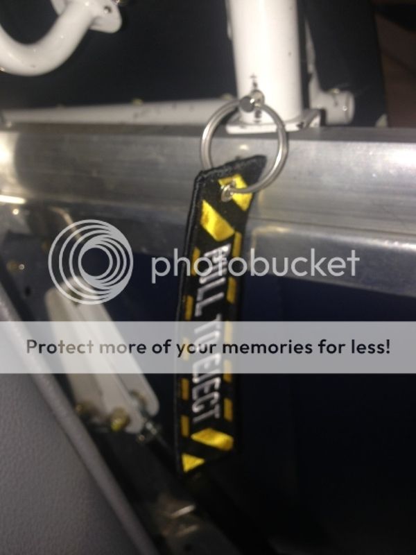

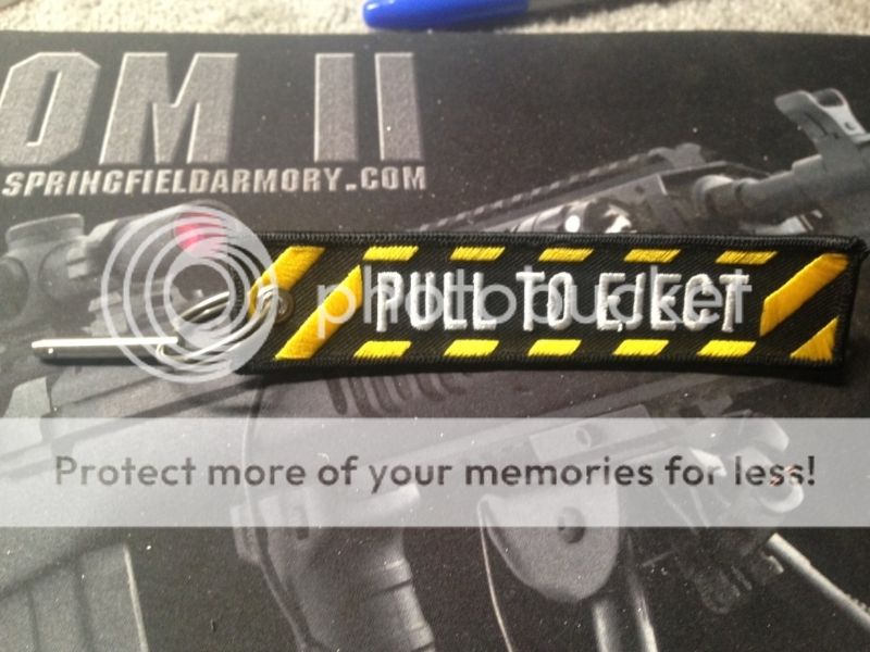

In searching the site a bit I couldn't find a real simple way to rig a canopy for jettisoning while performing aerobatics. Below is my solution.
Using a quick release pin I replaced the original fasteners that hold the canopy rollers in place. I put a pull strip on the pin to make it easy to grab onto.
See pin in place on left side roller.
The pin is a 3/16" Dial by .8" usable length. McMaster-Carr carries them, part no. 95255A216. They fit perfectly. I looked at the other styles with "T" and "D" handles but it looked as if they would strike the mid cabin brace sliding the canopy for and aft. There is not wobble in the rollers when secured by these pins.

That will work perfectly by just replacing the bolts with the pins. I assume you had the pull tag custom designed locally?

My experience with a partially open canopy in flight is there was a load on it, it would not move open or closed. (RV-7 not 8)
That load will be on the pins and they may not come out easily. Or if one comes out, the canopy may become cocked with a greater load on the other.
And there is no way to test it, is there. :)
I agree.
That is why I have always recommended to anyone doing this mod., that the procedure they use is to pull the pins before unlatching the canopy. Then pull aft on the handle without inserting fingers.
