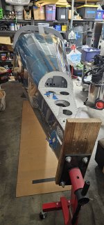

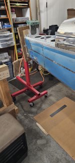

I mounted the body on 2 harbor freight engine mounts to make a rotisserie. Soooooooo much easier to do tasks. Lost count of how many times it's been on it's side, upside-down back to right side up, some times multiple times a day. Having the tail feathers on would make it really hard. Riveting the big join was way easier this way.
Dang! I forgot all about the Harbor Freight rotisserie technique. I had planned to do that so I'll be removing the HS and elevators tomorrow as I start my fuselage build.
Did you mount the tail cone on the rotisserie or after joining to the fuselage?
