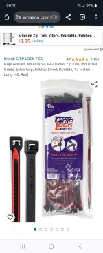

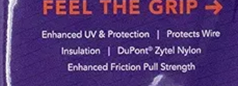

For those of us with less rigorous aerospace requirements but not wanting our motor mounts gradually sawn into pieces by grit under vibrating zip-ties: https://griplockties.com/
I camped next to the guy that invented these at Oshkosh a few years ago, and he gave me a few to try out. Tragically, he is no longer with us, but his family and colleagues are ramping up to continue production of these. I have 3 sizes, and have used them in several places, including FWF where an adel clamp didn’t work as well. The ability to release the clamp because you found something else that needed to be in that bundle is a great feature, and the cushioned rubber side protects what it is wrapped around. I hope they can stay in business.

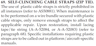

I will say that for naval aviation, zip ties are generally not allowed. I was an electrician on F/A-18s in the Marine Corps and we had classes specifically on how to properly tie a spot tie. Once you know how, it's not hard at all. When zip ties were allowed they are only allowed if originally specified by the aircraft manufacturer, which in the case of the homebuilt would be the builder. Here is a brief excerpt from the NAVAIR 01-1A-505-1: INSTALLATION AND REPAIR PRACTICES AIRCRAFT ELECTRIC AND ELECTRONIC WIRING .
