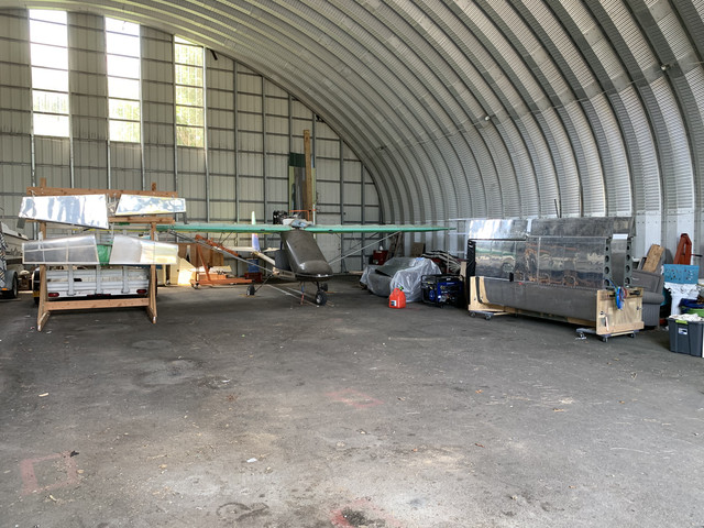

Hiccup. My wife and I decided to move to NYC (empty nest syndrome). She is from Manhattan and my moms side is from Brooklyn. Airplane goes into storage for a year and a half while I try to figure things out. Eventually I get the use of a hangar at an abandoned airport in Long Island. The hangar is the biggest and best one on the field (which isn’t saying much considering most of the other ones are in total disrepair). However I now have a means of building! I order my wing kit and buy a 12000 watt generator and on we go!

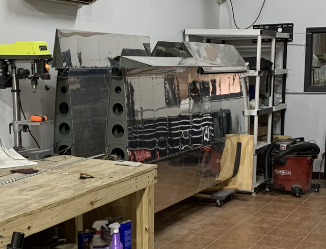

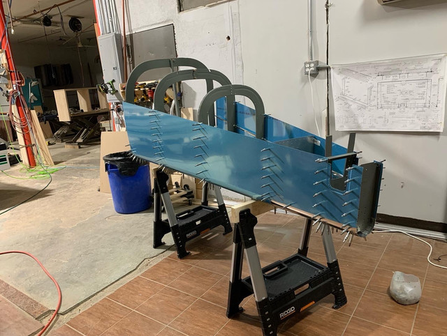

New shop I share with some woodworkers. Besides the dust and cramped space, this place is awesome and I’m lucky to have it. This is me spread out but being that all tables, benches, and jigs/stands are on wheels I can push everything to the side in the evening.

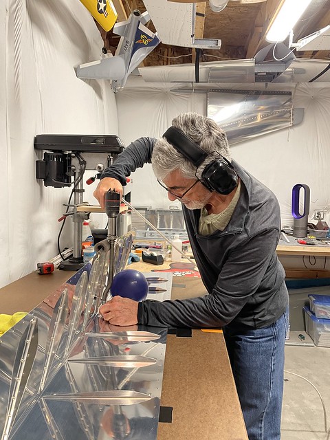

This is me using Wirejocks technique for lining up the baffle, z bracket, ribs. I screwed my first tank up and had to reorder parts and redo. Thank you sir, this worked so well!

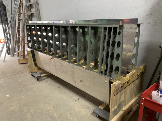

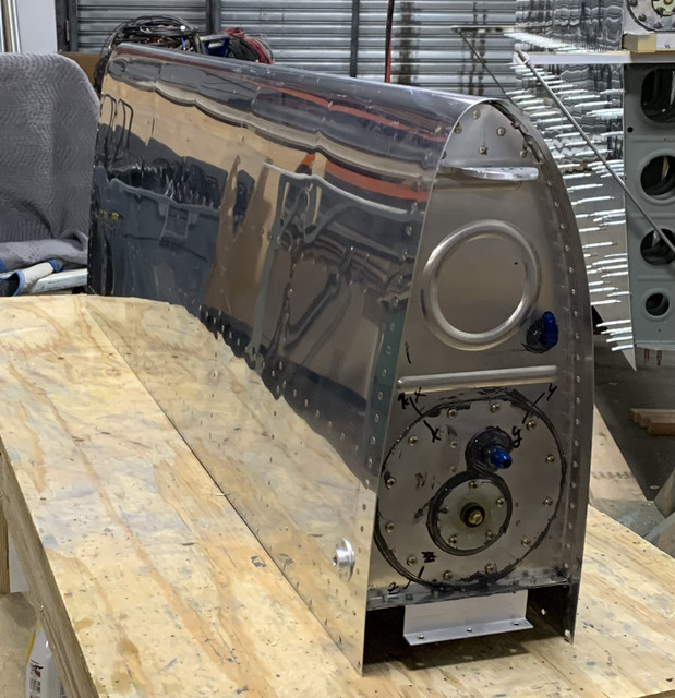

One fuel tank done, one to go. I am so sick of cleaning proseal off my clecos. Please let this end soon!!
Second tank went together much smoother and faster. Actually passed leak test with screws not prosealed though I’ll probably cover them eventually just in case.

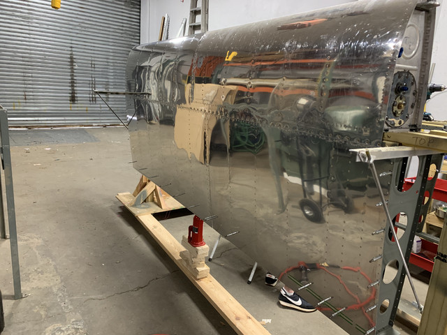

Finally finished tanks. Attached top skins. Flipped wings over. Like most people, this was a big deal for me.
I’m at that stage with my -8. And you’re right, it’s a big milestone! Suddenly you have wings!!!

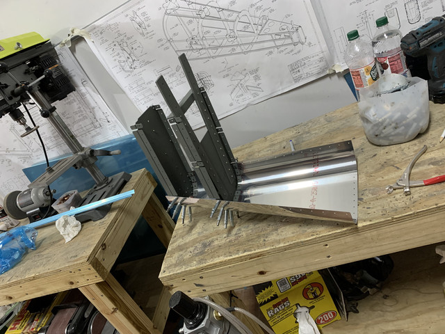

I took a break after my first tank and did my ailerons and flaps. It was a nice break before I got back into my other tank. Also the fact that the top skins was a two person job slowed things down.

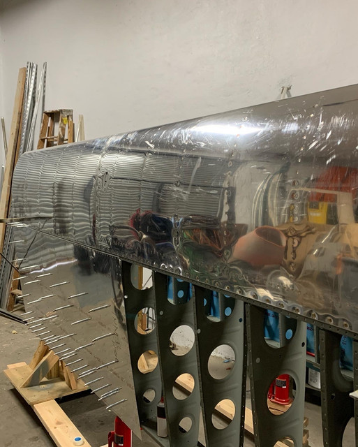

So flipping the wings over just feels like the end of a very long process.

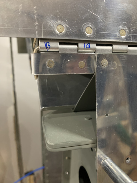

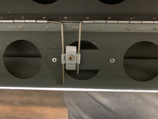

Pin
Might reconsider that …. Can’t be removed after the wing is installed. Center of the flap is a better option
If I have to deal with the hinge I’ll probably remove the wing. I can’t imagine that it will be a common occurrence though.
I agree with g zero. The center is the place to make your positive pin holders. In my 5 years of flying I did remove the flaps once. Don’t recall why, cuz these made it a non-event. Maybe paint?? If u have to remove yours u will contemplate it a long time. And likely regret it. This location is too simple not to do it this way. My opinion of course.
I used 2 separate hinge eyelets and mounted a #6 nutplate on each. Ez to take out. Ez to verify each is locked in place.
I’ve had to remove my flaps a few times after attaching the wings, for example to better trim inboard skin clearance to the fuselage. The wings were a bear to get on, and I never ever want to have to remove or reinstall those spar bolts. I would def. want to make sure the hinge pins could be removed with the wing attached.
Flap
Can’t imagine the pain to pull a wing if needed ……. Not something I want to do . Also installing a wing with a flap already attached doesn’t sound fun either.

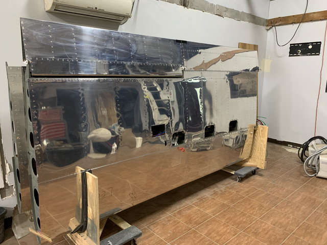

Wings complete. After much consternation of future issues and the nudges from others including those who responded on here, I got with the hinge program and did it like Vans recommends. Fuse kit coming next month!

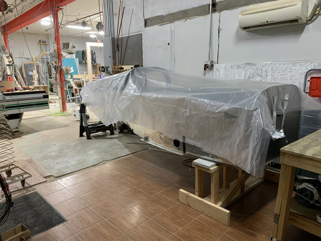

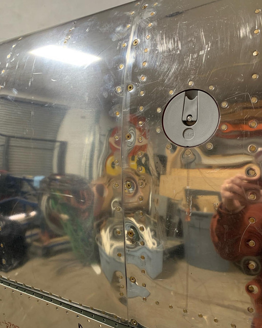

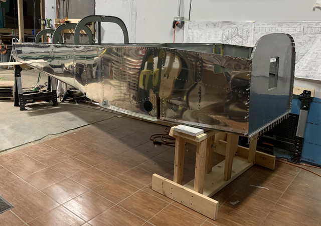

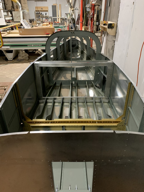

Finally flipped the canoe with the help of two others. Again, getting a riveting partner took some time so I could finish the side and bottom skins. Turns out that not everyone loves building an airplane as much as me.
I am building in a wood shop and sawdust is an issue. Now that the fuse is basically a big bowl I needed to cover it thus the tarp.
Also I lowered my forward stand to about 22 inches and it’s about right.

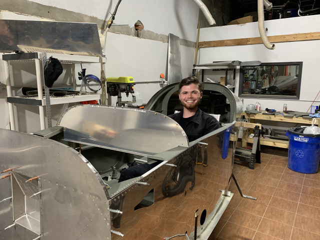

Finally got far enough along where I was able to sit in it. Wife and friend came by and both got climb in. I don’t take a lot of photos of myself building cause I’m too busy building. Wife (top pick) was impressed on the progress.

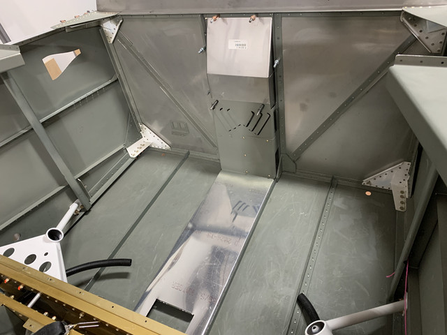

This is where I am currently. Im at the end of the fuse with several loose ends.

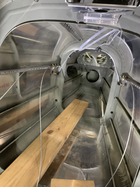

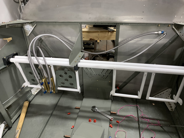

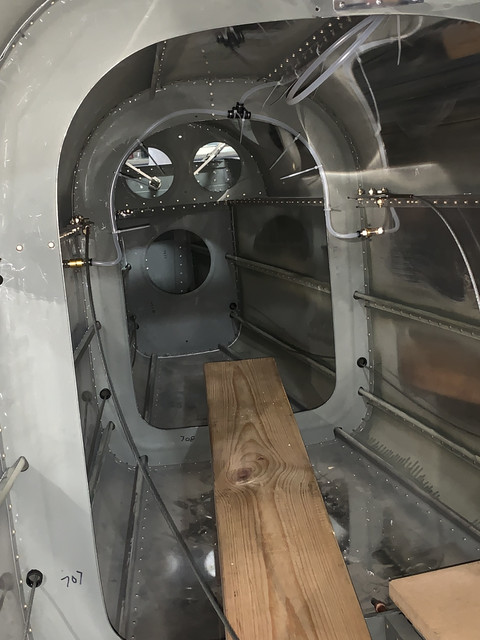

More progress while waiting for finishing kit. Looking for opinions on my static line install.
(I’ve since put in 90 degree fitting at the ports to elimate the sharp angle of the hose)
My son making airplane noises
Riveting partner. He has a background in racing cars.
TS Flightlines hoses and tubing. So easy.
Static Line Comment
The static lines should angle up from static ports so water/ condensate wont accumulate at bottom of loop . I found I needed to do that so water can drain via the static port to allow valid static pressure changes.
Adjusted the lines with a 90 degree fitting. Now just need the bushings.
My understanding of Vans original design was to avoid any upward slopes of static line from panel to static port such that any condensation could drain out the ports. That is why the line goes directly forward from the left port in the plans. "Pressure balancing" via centering the tee at the top is unnecessary. The center tee shown creates an upward hill that can trap moisture in the static line between the tee and the panel. If the line is only going to an AHRS that is mounted in the ceiling, then OK but it could still be better to go direct to one port or another.
Irv's installation concept (including "T" joining the two ports, and including upslope immediately after the static fitting) is consistent with Van's Static Air Kit plans from 2005 or so:
Yes, the inclusion of the tee follows the plans. My point is that the location of the tee in the build image does not follow the design intent from Vans and it matters. The t in the supplied plans is right above the left port, not at the top of the fuselage. It makes a difference in the slope of the forward going line.
Again, If an AHRS is being mounted at the top of the fuselage, all is well because there will be a downward slope from AHRS to the static ports. (On review of more of the images, I think I see an AHRS bracket poking out from the top)
If the line is going forward to the panel, then the tee needs to be low and the line needs to follow the left longeron in order to best drain condensation from the panel.
To be clear, I am not a "follow the plans" fanatic, unless the plans describe the best scenario from a physics standpoint. I am currently not aware of a better way to get the static signal to the panel than what the plans describe.

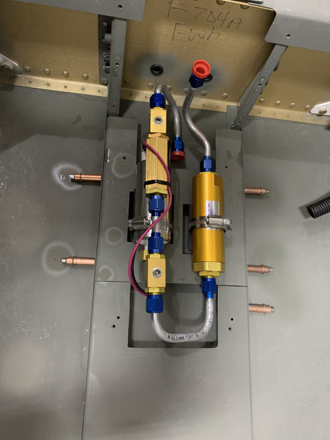

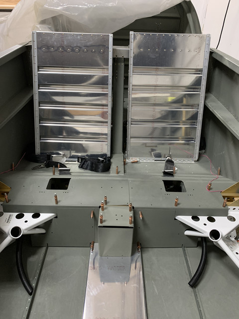

Making progress. Calling the canopy complete. Got the brake system and wheels fully installed. Final install of the empenage to final travel limits. Finished fuel system. Victor, an EAA tech counselor came over to help with the brake/wheel install.
