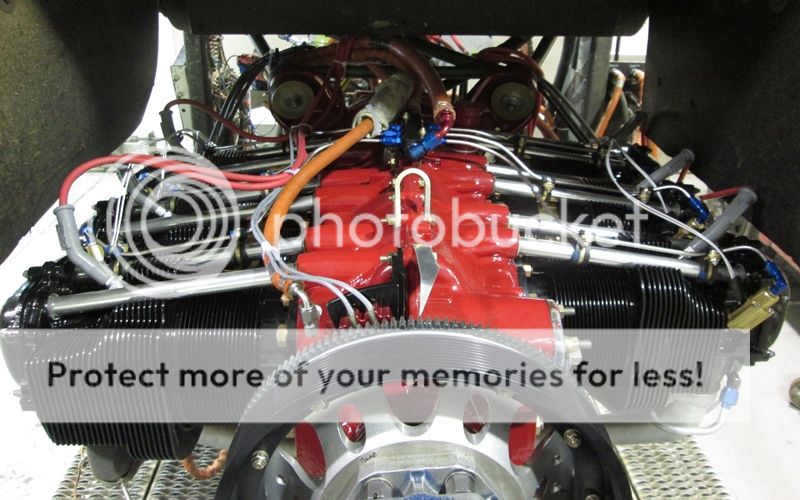

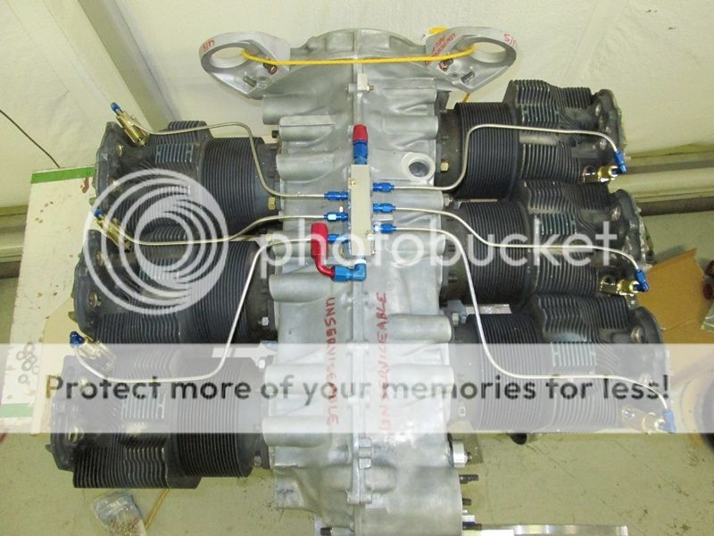

Here's a couple photos of the head mounted injector option for parallel valve Lycomings on a mockup engine (test fitting the hard line layout). This particular setup will eventually be going on a supercharged IO-540 in a Rocket.
Development will begin soon on a solution for angle valve Lycomings.

The hard lines will be supported in 2 places per line. This is larger tubing than what's used on Bendix type systems as well.
Installation is easier than drilling holes in the intake runners and stringing the fittings and short hoses together. Ease of installation is the main advantage and probably even better cold starting as well.
I don't believe there will be any hot start issue here since the fuel pressure is 40-50 psi vs. 1-2 psi on a Bendix. This substantially raises the boiling point of the fuel. At this time though, we're only recommending 100LL use until we get more results from hot weather testing in the Southern US.
Special materials were chosen for the part that screws into the head to reduce heat transfer on shutdown and we're using an injector with a stainless body as well.

So those are Bosch style injectors in some sort of machined housing? Does it require a mod to the existing (1/8 NPT IIRC) injector port? Would love to see that as an option on a 4 cylinder Lycoming if it proves out. Not super crazy about the injector adaptation on the intake tubes and resultant plumbing a la EFII.
Correct, these are a Pico type (very small) electronic injector with a narrow spray pattern. No mods required on parallel valve engines- take the pipe plug or Bendix type injector out, screw these in, done.

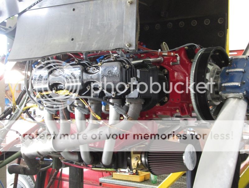

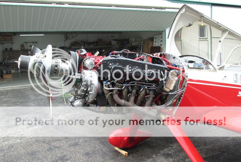

We ran Bill Beaton's new IO-540 at Aerosport Power last week with SDS EFI. This had the new top mount injector bosses and 80mm billet throttle body replacing the old mechanical injection setup.
Note the new, wider pulley to drive the supercharger. (not installed for break in).
We ran one set of plugs off the SDS EM-5 ECU and the other off an SDS CPI unit.
No hot start issues so far.

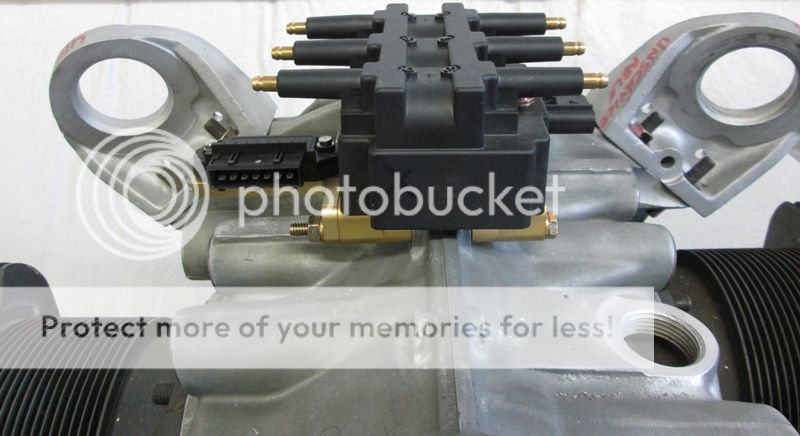

Top Coil Mount
We just finished another new CNC'd part for 540 engines. This is a bracket to mount the coil pack to the top, rear case bolts. It allows the top plug wires to stay inside the baffling for a cleaner installation.
It's applicable to both the SDS EM-5 engine management systems and the CPI stand alone ignition systems.
We have a similar mount for 4 cylinder systems.

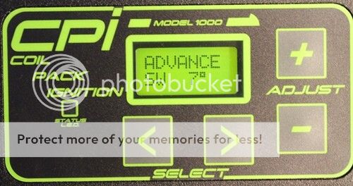

We enter a conservative base timing curve taking into account the fuel used (Mogas or 100LL) and engine compression ratio. The advance switch on the CPI or EM-5 allows you to add a programmable amount of timing advance for LOP or high altitude operation or can be used as an octane selector if you run both Mogas and 100LL.
Here's what the CPI advance switch window looks like above. Program the amount you want and when you flick the miniature toggle switch on the panel, this would instantly add an additional 7 degrees at all rpm/ MAP ranges.
Here's the same window on the EM-5 programmer
As Mike's flight testing showed, this feature can add several knots when running LOP.

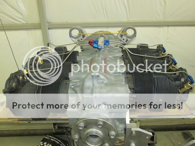

6 Cylinder Fuel Trim
Just an update on progress on new SDS EFI features for 6 cylinder engines: Software is complete and we're finishing bench testing on the individual cylinder fuel trim option this week and will be continuing with engine testing after that before going on to further engine testing later in August.
This will be a twin ECU board offering, with backup and a new relay switching box to go with the system. We believe that this option will be available sometime in September if all goes smoothly.
Along the same timetable, we'll be finishing the CNC'd production top case mount fuel blocks for Lycomings.
This last piece will complete the basic EFI/ EI mechanical kit parts for PV and AV Lycoming 540 engines with 80mm billet throttle body, top injector mounts, 3 choices of coil pack mounts, mag covers, fuel pump cover, 2 choices of fuel blocks, dual fuel pump module, dual board ECU, single or dual Hall sensor body with mount, short and long reach plug adapters and air and CHT sensor mounts.

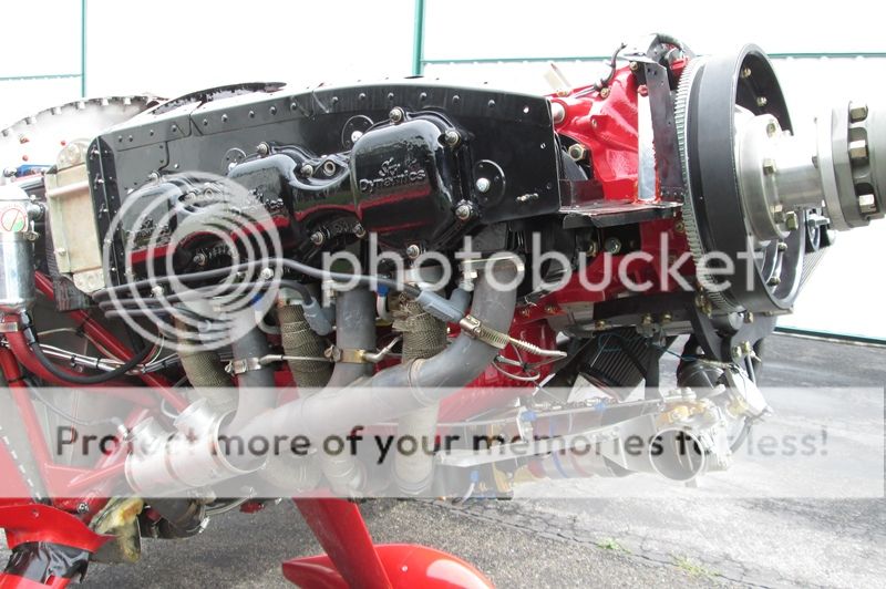

Supercharged Rocket Running Today
We we running up Bill Beaton's mighty supercharged Rocket today with the SDS EFI and CPI. What a beast!
Hopefully I can post some photos and vid links soon with Bill's permission.
Looking out my office window here, I see Bill is up in his Rocket overhead, breaking in his new engine. Has a distinct sound with the supercharger on there. Sounds good!

Here are a couple of photos of the supercharger setup on Bill Beaton's Rocket. Test flying is proceeding as weather permits. Slowly working out the bugs, hopefully in time for Reno.
That's quite a prop extension on an already extended hub Hartzell...
Got any pictures of the cowl?
I have started my EFI installation, so I'm looking forward to hearing some performance numbers from this beast (not that my little 260 is going to compare...)
Prop Extension
I probalbly have a picture of Bill's plane with the cowling on. I'll post it if I have time to dig it up. I agree, there is a lot of potential load on the nose of that crankshaft between the extended hub prop, the extension, AND the centrifugal blower drive...
Skylor
Bending loads through the extra moment would be the bigger concern. The radial load from the supercharger drive is tiny percentage compared to typical firing loads on the bearings.
It's all very experimental however...
