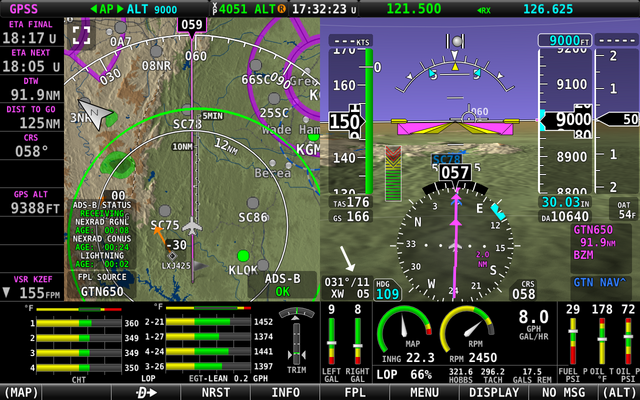

Whats cruise like at a more average power like 65/75% ?
Standard “I want to get there but not blow too much gas” cruise.
IO-360-M1B with AFP FM-150C, standard 74” Hartzell BA prop.

Carl, perfect! Provides a very close cruise comparison with an early 210 HP 390; same prop, both 66% power and ~0.4 BSFC (0.404 vs 0.398).
The math to predict speed based on the 390's extra HP is...
180 x .66 = 118.8
210 x .66 = 138.6
176 knots x ( 138.6 / 118.8 )^1/3 = 185 knots
...and here I'm showing 187 with Ms Patti on board and a bit more gas. The addition is in the scatter, or reflects less drag due to the fastback and a closed cooling outlet, depending on viewpoint.

Manifold Pressure
Carl,
What air inlet system are you running to get 22.3" at 9000'? Ram air of some sort, or the cowl inlet intake with a snorkle? I'm curious.
I know Dan has a pretty well documented filtered ram air system (nicely designed and tested), and you seem to be matching (or beating) his MP.

This is the stock snorkel but using the AFP FM-150C. At some point I’ll modify the snorkel following the lead of what was done on the RV-14 with the shift over to the IO-390-EXP119. They got a nice bump in MP from this mod. I’m using the FM-150C and not the FM-200 like the EXP-119 uses so I suspect I’ll not get as much gain.
Carl, might want to check that MP indication.
Run the numbers. At 9000 ft, 176 KTAS, and 54 OAT, pressure is 21.39" Hg and available dynamic pressure (q) is 1.07 Hg.
Can't get 100% conversion of dynamic pressure in an open-ended system. The ballpark is more like 75%, thus q applied to increasing MP would be roughly 0.8" Hg, not the full 1.07".
Next consider manifold pressure loss due to flow through filter, fiberglass snorkel, the FM150, and the intake tract between the throttle and the cylinder head. How much is the loss? My airbox has a larger filter, no duct, and no entry bend. The smaller throat of the FM150 results in 6" H2O more loss than an FM200. The M1B and the 390 have the same horizontal intake sump. Having measured my total intake loss at three altitudes, I'd estimate your 9000 ft loss at about 15" H20, a bit more than 1" Hg.
So, 21.4 + 0.8, less 1 = 21.2", more or less. 22.3 is unlikely.
Awhile back Dan saw that my MAP was also reading high. I did the ground calibration (several times on different days) and adjusted it in the Dynon menu:
Ended up adjusting it down by 0.5" Hg:
