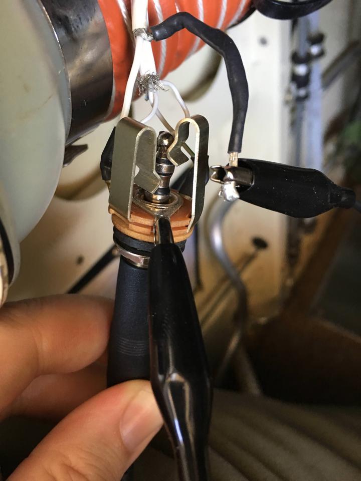

Update: So I believe I figured out what the issue was. Now I need to figure out how to fix this permanently.
There is a shield on the mic cable that needs to be connected to the ring of the pilot mic jack. This enables the ptt button to short the mic tip to the mic lo ground. See attached picture.
As depicted, I was able to use the intercom and communicate on the radio with ground control.
I am not sure how this solder joint was accomplished before as I can’t find where the solder joint must have broken away from. It does not look like it pulled out of the ring connector terminal on the jack (which also has another wire soldered in there at the moment; other side of jack to alligator clip shown in picture).
Ideas for how to fix this connection in a permanent way are appreciated.

Terminology (pardon the unavoidable pun): tip, ring, shield.
The wire's shield connects to the jack's shield; not the ring. :-) The ring gets mic audio, in this application.
Your test clip is on the shield terminal. That's where you want to solder it. It's likely that the builder just got a 'cold' solder joint there when he built the plane. All that's needed is to resolder the shield to that terminal. If you've never soldered anything, just ask for help at your local eaa chapter. It will take longer to get the iron hot than to repair the joint.
Have fun with the 'education' half of experimental aviation....
Charlie
Edit: it looks like the builder did everything right except the actual soldering, so no need for any extra wires, insulating, etc.

Thanks for making sure I was using the right terminology. I appreciate it - would have been bad if I had told avionics guy solder wrong thing...
Discussed with an avionics guy that was able to solder everything back together correctly.
Tested with master on, it worked when calling ground ? ?loud and clear?. Tested with co pilot side headset with in line push to talk and it worked when calling ground ? ?loud and clear?.
