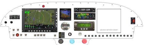

What is your opinion specifically about Symmetry..... I know it comes down to choice, preference, compromise. What do you think of these three...Sometimes it is stand back, close one eye and hold thumb up and say looks good or good enough. My thoughts
Top - symmetric (to center bolt) has access cover is same size as EFIS so a second screen could be added. I am not likely to add a second screen however.
Middle - semi symmetric as a less crammed in to the left, but still good access to the center stack.
Bottom - Asymmetric and more room to add another gauge. ( I already own, the Davtron M811b timer and the G-meter, both handy)
I am leaning to the middle one because it looks nice, Also if I want to add gauges like the clock/flight/timer or G-meter they can go in the access cover. They require little to no wiring.
What is your experience, suggestions, cautions, regrets about symmetry. (Note: majority of the equip is locked down, bought, test wired ready to mount. Location of switches, power jacks, dimmer, intercom still in flux, and I own a box of circuit breakers so those are also firm.)

I vote for Symmetric. I considered an asymmetric layout but my brother (Walt) convinced me to go symmetric and I am glad I did - it just looks more balanced. (Research as shown that people with very symmetric faces are more attractiv).
I have dual G3x’s with a GTN 750, GMC 305 and a garmin audio panel in the center. I have a G5 on the far left side & CBs on the far right side.
I think “balance” is a better word than symmetry. You can have an asymmetric panel as long as it is balanced in visual “weight”.
Keep in mind, you can see and reach everything easily across the panel in a 7.
Here’s mine. It’s not symmetrical but has pretty good balance. It gets harder with the big screens when you don’t put two of them in, but it’s still doable.

I don’t like the bottom one because the gps is too far from your line of sight to the attitude indicator.
I’d also put the EIS at the bottom. You’ll never need to look at it. However, as suggested above, maybe high is needed to avoid re-engineering the support rib behind the panel?
Layout #1 center rib likely interferes with GTN 650. Layout #2 center rib may interfere with GTN 650. Layout #3 GTN likely misses center rib, but right edge will be close to outside rib. In all cases, do not underestimate the room required to interconnect and wire the components. In all cases, the subpanel will have to be cut, at least for the GTN 650. I ended up cutting a huge hole out of the subpanel from the LH outside rib to the RH outside rib. But then, I had to reinforce the sides of the subpanel with 3/4 x 3/4 x 1/16 angle and add a 1" x 1" square aluminum crossmember to tie the subpanels back together.I did not have to cut any of the ribs as my radio stack was similar to your Layout #3. Do not underestimate cramming all this stuff (esp radio stack) between the ribs and the subpanel.

I would check the Navigator installation manual. I dont think the bottom one meets the requirements, but I could be wrong. When I laid out my panel, there was a requirement for viewing angle to the pilot.
Also, Imwould avoid using a keyed ignition switch. I think toggles for the mags and a keyed starter switch is the way to go. The keyed ignition switch is a single point failure. Mine failed ( in the air) during phase 1 at 10:hours.
I would check the Navigator installation manual. I don't think the bottom one meets the requirements, but I could be wrong. When I laid out my panel, there was a requirement for viewing angle to the pilot.
I don't disagree. A good new Bendix key switch Off R L Both Start are $500. PMA'ed they $615. I have Mil-Spec Locking toggle switches planned. I just showed it to see what it might look like. It is handy doing the work of three switches, two mags (P-Mags) and start. Also it adds some security. Still working on the ignition/start switchology and security.
As far as the GPS175 viewing angle, good point. There is a thread on VAF which has good info.
https://vansairforce.net/threads/field-of-view-angle-requirements-for-garmin-navigators.207537/
I don't think it is an issue but a consideration. The viewing angle is within limits of the screen it self, but there are human factors. The Canadian Policy Letter (PL) on this subject (link in thread above) indicates recommended center of AI to Navigator be about 13" apart. Coincidently my bottom sketch has center of EFIS to GPS is 13 inches apart. FAR Part 23.1311 & 1321, addresses location of instrument topic as well. However USA built EAB's are not controlled by Part 23 or Canada. Still wise to look at all this information. Thanks for the tip.

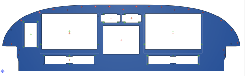

Definitely symmetric. That's just who I am. I'm an accountant and work is all about the debits equalling the credits, or literally, the left equalling the right. It flows over into other parts of life: every Lego assembly is always symmetric, right down to the color of the bricks. And so goes this in-process panel...
Is there something wrong with this graphic? The instrument holes are symmetric to the panel, but the rivet/mounting holes across the top aren't symmetric somehow, because the center hole isn't centered on the gap between the two top center instruments. It looks like the spacing on the three holes right of center is smaller than the three holes left of center?
Personal preference would be #1. Symmetry. I know you don't plan for a second screen right now, but at least it'll be an easy option down the road. In the meantime, your passenger can velcro their iPad there for an in-flight movie, you can have a large glove compartment/lunchbox that won't spill things when you hit turbulence, etc. Having the instruments "tight" together on the left won't even be noticable.
I'm pretty sure that the Symmetric layout also places the EFIS dead center in front of the pilot... Relaxing it to the right a bit means your head always has to turn a few degrees to look at the screen. A small thing in VFR, but maybe larger in IFR?
The hole spacing is correct. The 3 forward ribs behind the panel appear to have their webs evenly distributed while the rib flanges, where the panel attaches, are folded one way or the other. The outer 2 are mirrored while the middle had to choose left or right. I had the assembly together quite some time before I noticed.

I like having the EIS in the radio stack. On my planes I put it on top and default to the fuel usage page so I always have fuel usage available and easy to see.
i do however get the bezel that grt offers for the EIS. It makes it a perfect fit for the radio stack. It’s $100 but I think it’s worth it.
YMMV
