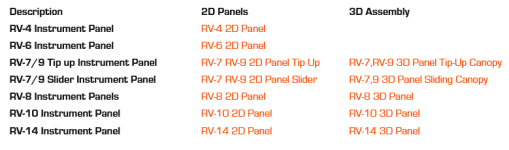

I am thinking about a custom panel for my RV-12. I notice on Van's website they have CAD drawings for instrument panels for all the other models but not the RV-12. What gives? Any idea where I can get CAD drawings of an RV-12 instrument panel?
Here is the response I got back from Van's tech support...
"Due to the proprietary nature of the data, I cannot send you the CAD version of the panels."
That sort of surprised me. The "Downloads" section of their website has CAD versions for their other aircraft.

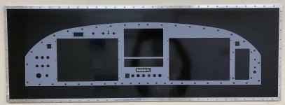

I have .Dwg files for a one-piece RV-12 panel and the three sectioned panels that were created from a laser scan of the original RV-12 three-piece panels. I have only used the one-piece version for water jetting the panel I have installed. I did separate the control mount in the center section so the panel can be removed and installed without messing with the throttle and other cable controls. I also have CAD dwgs for a custom radio mounting bracket for the center section that replaces the smaller OE RV-12 bracket and supports the center of the one-piece panel.
Here is a photo of the second prototype that was turned into wall art. PM me if you want any of the dwgs.
