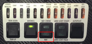

First, do you have any kind of a wiring diagram? Do you have separate switches for strobes and nav lights (if the answer is "no" this would be strange. You'd like to turn off the strobes if you're parked right next to someone on the runup ramp, but not the nav lights, if it's dark).
It's a single switch on/off which controls both nav and strobe. There's no option to turn on just the nav lights. I don't recall any separate wiring diagram in the documents, but I'll look again. I've been trying to figure it out using the kit assembly instructions, but no luck so far.
