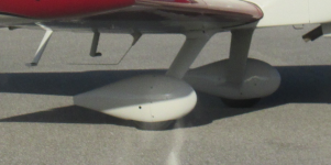

The Happy Face (thanks to my daughter) is actually a 1.5" diameter pop-out plastic plug, strategically located for easy access to the valve. A while line on the inside of the tire is used for fast alignment of the hole to the valve - when the white stripe on the tire touches the ground, the valve will be in the correct location.
Light. Simple. Inexpensive. Works.

The plug is simply a plastic pop-out plug that you can purchase from many outlets around the world. Here is a link to the place I bought mine from:
www.farnell.com/datasheets/1933947.pdf
I used one like the last item on the list that is 1.5" in diameter. I bought a white one and put a vinyl sticker on it.
Hope that helps.
