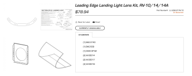

Paul, thanks to the great advise on the forum I’m sold on the Seven Star lights for my RV10. I checked the Vans website and I’m having trouble determine which kit I need to buy to modify the leading edge. Some of them seem to be unavailable. The RV10 is from the 2009 era so I will need to cut the holes in the leading edge and install the brackets and lens. Thanks for any advise.
Hi Robert
This is the kit that you want, and yes it appears to be out of stock at the moment. https://store.vansaircraft.com/rv-10-leading-edge-lens-kit-ll-lens-kit-rv-10.html
Duckworks Aviation also has a kit.
I’m building a 7A and have the flyled wing tip works combo lights. I’m not flying yet. I’ve gone back and forth on adding a leading edge light as I’ve seen others comment that the wing tip lights have a dark spot directly ahead of the plane.
Hi Dustin
The corner light bay in the W-715-1 wingtip for the RV-7 & -8 is much wider than the rest of the RV fleet, so to the best of our knowledge (after many hundreds of installations) shadowing is not a problem for this wingtip type.
You could always run an extra 16AWG wire in the wings so that if you decide to add more light in the future that job is done.
I have regularly been able to call Van's and order things that aren't in stock, so it's worth a call.
As is frequently the case with Van's, "kits" are listed as backordered simply because the individual part numbers in the kit are not already "picked."
All of the parts needed for LL LENS KIT RV-10 are listed as "in stock" with the exception of DWG OP-52, which is a drawing.
In other words, place an order for "backordered" LL LENS KIT RV-10 and it will ship.
Good to know! Also, ironic, since the OP-52 plans that they ship you aren't printed to scale in my experience, so I had to reprint them anyways (so the template is actually usable).
