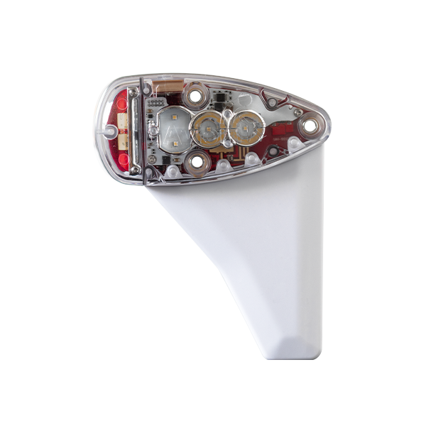

Like many RV-6s, this airplane does not have a rear position light mounted on the tail. Instead, it originally had rear-facing position lights integrated into both wingtips, which made it compliant for night operations.
The issue started when the previous owners tried to make the airplane ADS-B compliant. The airplane has a Trig TT21 transponder and a Garmin 430W, and they attempted to use that combination for ADS-B Out. Unfortunately, after numerous attempts and what sounds like a lot of time and money spent with an avionics shop, they were never able to get a reliable ADS-B Out solution working.
As a result, they went with a uAvionix SkyBeacon on the left wingtip. In many ways it was a great solution. It provides ADS-B Out, a strobe, and a position light all in one package. The problem is that the SkyBeacon does not include the rear-facing position light that the original wingtip light assembly had.
So when the original light was removed, the airplane lost one of its rear-facing position lights. As it sits now, the rear of the aircraft can only be seen from one side at night, which is why the inspector says it is no longer night legal. So now I'm trying to determine the easiest and most practical fix.
The options I've thought of so far are:
I'd appreciate any advice or ideas. Thanks!
- Install and wire a dedicated rear position light on the tail. The challenge is that the airplane doesn't currently have a mount/fairing for one.
- Replace the transponder with a different ADS-B solution and go back to a conventional wingtip light assembly. Effective, but very expensive.
- Add a separate rear-facing position light somewhere on the wingtip. This would likely require some drilling and additional wiring.
- Have another avionics shop take a crack at getting the TT21/430W combination working correctly so I can remove the SkyBeacon and reinstall the original light assembly. However, given the amount of effort that was apparently already spent trying to make that setup work, I'm not very optimistic.
