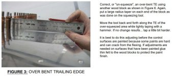

I was ask to inspect and deliver an airplane this last weekend. I went and looked at it as I have done many times over the last 38 years. It was a very nice built and finished airplane, professional painted. On occasion I find an airplane that really stands out and this one was not in a good way.
This plane was so touchy to control that it was a handfull to fly even with all my experience. I seldom write on this forum but hopefully this will help some one else have a better flying plane. I have preached this to my students for many years. These two things will improve how your plane flys a lot. This will apply to RV-3 4 6 7 8.
1 Do not cut 6 inches off your control stick. It was designed to be the length that it was shipped in the kit. If you want to cut it down to put on a stick grip make sure you put back to the original length. Nothing I can think of worse than trying to negotiate a strong gusty cross wind with a touchy airplane that has the stick cut off to down between my legs. If you think I'm wrong on this take the steering wheel off your car and replace it with a 4 inch steering wheel and see how it goes. Van has wrote several articles on this and yet I still find lots of planes in the field that have really short cut off sticks. To make things even worse go to high altitude and load up the baggage compartment to make a rear CG and you have a really touchy hard to fly airplane when you cut the stick off. Over the years I used to carry some stick material with me so i could extend the stick back to the proper length before i ferried an airplane.
2 Make sure that the trailing edges of the ailerons are squeezed properly. This one very simple to fix item can make your ailerons nasty to fly. I find this a lot when test flying new planes. The trailing edge does not get squeezed enough and it makes this thing called aileron snatch. Aileron snatch makes the aileron very sensitive and unable to center. Give me 10 minutes and a hand seamer and I can fix this. A straight edge and a hand seamer can fix promptly. The particular plane that I delivered this weekend had terrible aileron snatch. Interesting that this plane had flown 700 hours this way and the original owners thought it flew great. I let the new owner fly it before I fixed it and he could believe how much different it flew.
I wonder how many other airplanes out their fly like this one did and could be improved a lot.

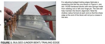

The models listed have ‘folded’ trailing edges on the ailerons. The 10 and 14 have 2 piece, riveted trailing edges, which cannot be squeezed.

Pillowing trailing edges are also the major cause of skin cracking around the most aft rivets.

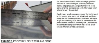

As Larry wrote, there is fairly detailed instructions in SECTION 5 on how to evaluate the shape of control surfaces with bent (vs riveted) trailing edges, and how to adjust them if the shape is not correct.
The shape / profile is far more important than the actual bend radius of the trailing edge.
This is equally important for the ailerons, elevators, and rudder.

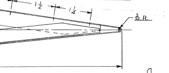

From the Construction Manual, in the section on building the ailerons:
The bent skins must be straight up to the radius and the radius must be between 3/32” to 1/8”. Match the degree of bend to the full size end view drawings. The upper and lower skin should just touch the spar when placed in position.
It should be noted to not make the TE bend any tighter than the radius measurements above. Minimum sheet metal bend radius allowances assure that stress cracking does not develop in the bend. I came across one elevator that had been over bent & cracked in some places, and had to re-skin the unit.
The manual describes a bending fixture to use during construction. I found this good for the initial bend of the TE, but later after riveting, to finish off with a hand seamer as Mike described. Specifically a vice grip style hand seamer that can be adjusted to gradually pinch in the TE radius to a consistent radius. The other trick I use with the vice grip hand seamer is to lay a towel folded 3 layers thick inside the jaw to protect the seamer from making pinch marks at the ends of the jaw all along the TE.

Fit this up against the aileron every inch along its length and you will quickly see, top and bottom, where the trailing edge needs adjustment. Made from the plans for my RV6.

A straight edge laid cord wise as shown in Section 5 is about as accurate of a method as you will find. Not sure what the benefit would be in making a special tool. Especially since you would have to make a different one for each control surface.
