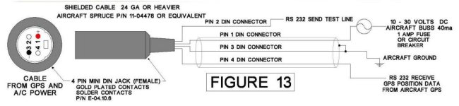

I don't know if it's the same on his checklist but I have an ELT task on mine. The GPS data stream requires power from the aircraft. I put mine on the battery bus which necessitated a switch to turn power off.
Thank you Jereme.
Chris
