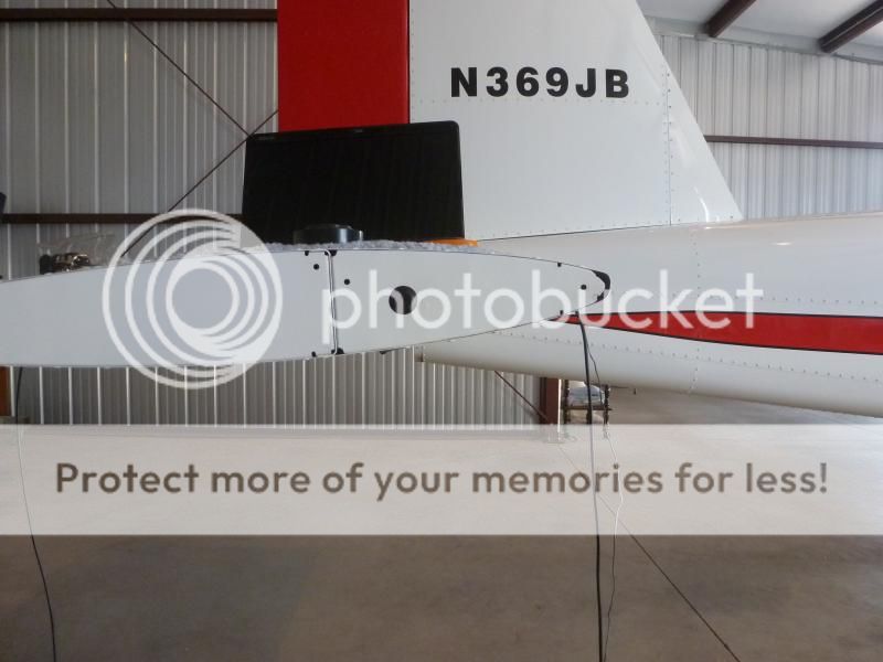

OK, on the very, VERY minor chance that I do see any cracks (NONE when it was built) when I'm able to borrow a suitable borescope, just WHAT the heck am I supposed to do then? The notice says that any visibile cracks are to be "dressed". To me, that means removing material all the way to the end of the crack, not just stop-drilling it. BUt HOW am I supposed to do that without removing the stab skin??? Memory (OK, it was almost 5 years ago) says that there's no way I van get my hands, let alone a drill or file, with the skin in place. Help??
Wayne 120241/143WM
From the "notification": Step 12: If cracks are found contact
Van's Aircraft technical support for
further instructions and information.
If no cracks are found no further action is required.
MY INSPECTION
Drilled 1/2" holes in end of HS for endoscope. Worked fairly well. Can touch up plugs next paint time.
I like!!
I had my stabilator off for paint so I could inspect from the inside moving out with an inspection scope. Now it is re-installed and I do not want to take it off every year for an annual inspection.
This inspection access at the ends through a half-inch hole looks pretty good to me. Any other ideas are welcome.

Took the measurement for Keith Williams cause he did the same. My 1/2" hole is located 7 1/8" from the leading edge. Same location as John.
Chrome plugs
The aviation departments at Lowes or Home Depot have chrome plugs in various sizes used by plumbers to cover goof holes. I used 1 1/4" ones on my wheel pants to get at the tire valves without removing the wheel pants. Have used them on other planes and have never lost one yet.
