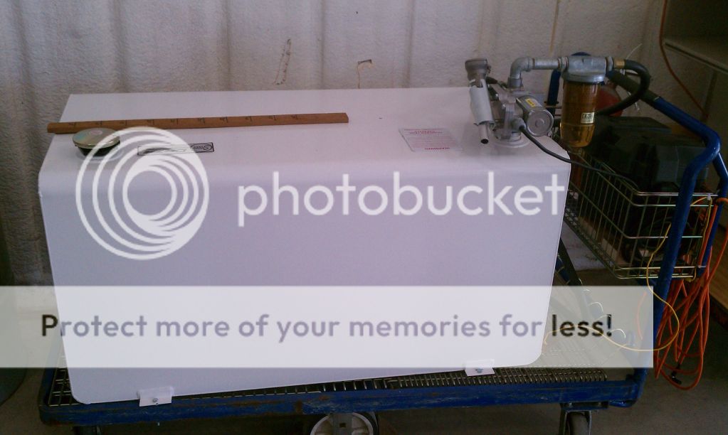

100 gal tank setup from Tractor Supply on Sams cart bought from a recycler.
