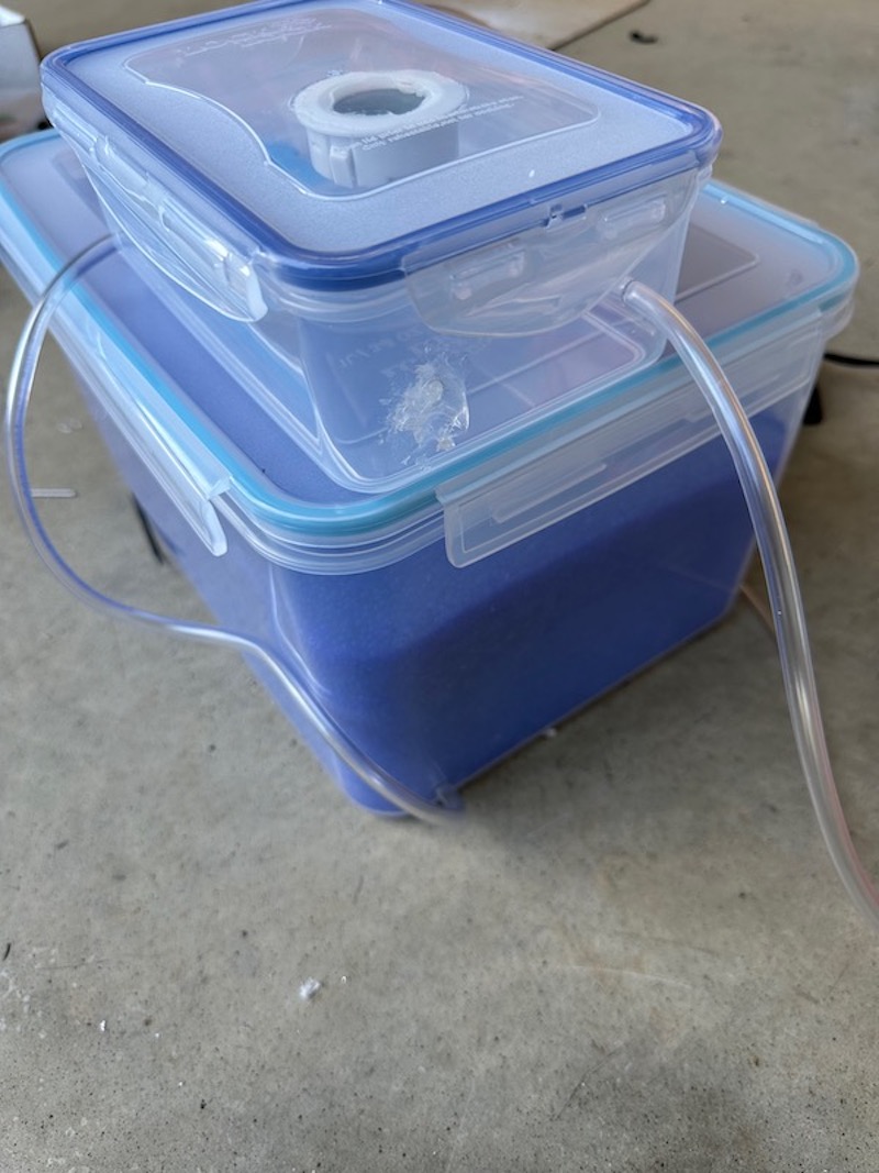

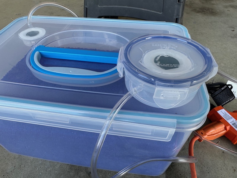

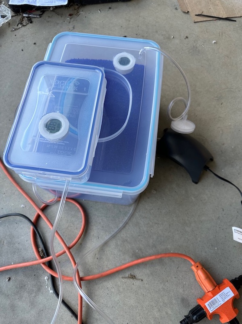

I've got quite a bit of travel coming up and my engine has been out of the bag for going on 6 months now. Based on that, I thought it wouldn't hurt anything to throw together an engine air dehydrator as I've seen others do.
This was all made with amazon and dollar store parts and literally just thrown together with duct tape in the short time I had before leaving on a trip. Total cost was about $80, with the desiccant being the most expensive component by a large margin. I'll pretty it up with an actual base and frame at some point.
Full disclosure, I've also got desiccant plugs in the upper spark plug holes, but I've never been convinced that they really do much to help with what might be going on down in the guts of the engine.
The humidity drop after only a few minutes of operation is pretty dramatic, although I have to confess I'm a bit skeptical of any reading I get from a $10 battery powered hydrometer I got from Amazon.
I originally got fancy and had this running a few hours a day on a timer, but the humidity would come up to about 20% within a few hours of the pump shutting off. I suspect theres a good chance this is just ambient air leaking around the lid seals on the cheap dollar store food canisters, but at any rate, for now I just ditched to timer and let it's do it's thing 24/7.
The white and green stuff sandwiching the desiccant are just some scotchbrite pads that serve no purpose other than to keep the desiccant from sloshing around in there.
The plumbing pulls air from the breather tube into the gauge chamber, then into the pump, then through the desiccant chamber, then back into the dipstick tube.
Not making any claims about whether this is necessary or not, but I figure it cant hurt.
edit- in case it's not clear; picture 2 was reading ambient temp/humidity before I plugged it in. Picture 3 was about 10 minutes after flipping the switch.

That's the only way to keep the humidity level down. Unless you want to build a vacuum stable container.

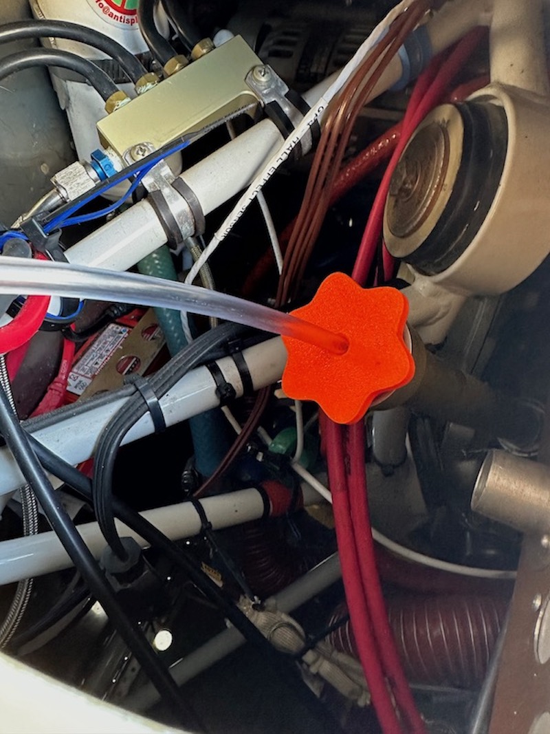

Here's what I ended up with. This wouldn't be convenient for a flying airplane, but thats not what I'm talking about here. I just want keep the humidity low inside the engine while I'm still in the build phase.
suction side:
Got an appropriate size rubber plug at ACE hardware. Drilled a hole in it. Shoved suction side aquarium tube through. Pulled the crankcase breather hose off the downspout at the firewall and stuck the plug in the end of it.
return side:
Bill Wood (decathlon737) made a bunch of 3D printed caps that screw into the oil filler tube in place of the dipstick a few months back and was mailing them to anybody who asked for one. I put a hose barb in one and stuck the return side line on it.
Both lines just got taped to an exhaust pipe out of harms way so I can get the cowl on and off without tearing them up.
ezee peezee.

I have a 3D printed cap that screws into my oil dipstick tube...this is where the dehydrated air is pumped in. For awhile, I returned air to the pump with some poly tubing that slipped nicely over the output tube of my oil separator. I ultimately decided that it was too much of a PITA to get under the plane to plug it in after a flight, so now I just run it open-loop. Works fine.

I built this a few weeks ago & meant to post about it, but I forgot until I saw this thread. Also built entirely with components from Amazon. Since these pictures were taken, I have replaced the smaller return air reservoir with an even smaller (5 oz) container to reduce the sensor lag.

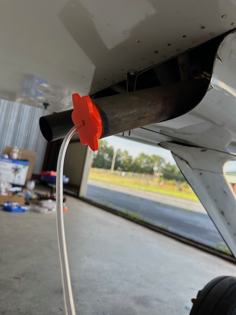

3D-printed threaded oil filler cap & tapered exhaust plug.
I have the Antisplat oil separator and crankcase vacuum kit installed, so this provides an easy way to do a closed-loop dehydrator, with the exhaust plug easily accessible with the cowl on.

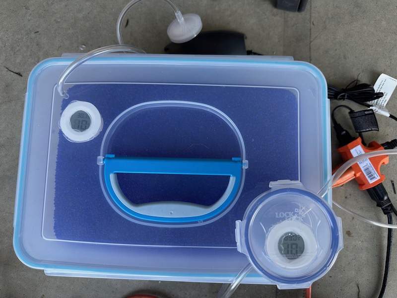

Hi David, what humidity are you getting with this system?
Take a look at the second picture above - 10% at the intake/return & the output sides. This was after the system had been running for a few hours. The first picture shows 88% (I think) at the return- just after shutting down the engine & hooking up the system.
This is in Georgia, where the humidity stays high most of the time.
These are $2 hygrometers; not sure how accurate they are. I'm ordering a better set of sensors & a data logger to see how long it takes for the humidity to come down.
Current hygrometers (Amazon)

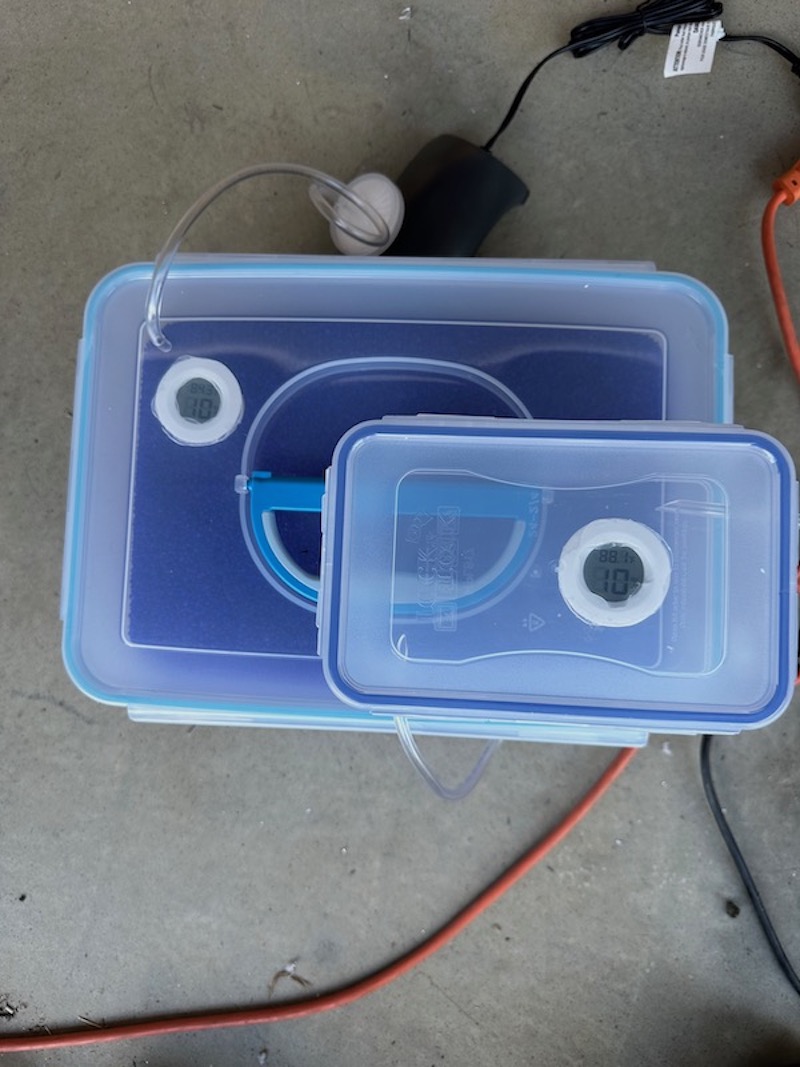

A couple of pictures of the smaller return airbox
Note that no fancy (and expensive) tubing connectors are used. I drilled slightly undersized holes in the plastic containers & poked the plastic tubing through. I found that cutting the tubing ends on an angle helped get them through the undersized holes. We're not pulling a hard vacuum here, and what's the worst that can happen? We get a little ambient-humidity outside air into the system. If it makes you feel better, smear a little clear silicone sealer around the connections.
I put a filter inline between the desiccant chamber & the air pump. Don't want any desiccant dust getting into the pump or the engine.
I've become convinced these $2 Chinese hygrometers probably only read down to 10%. I've never seen them read any lower. Better humidity sensors are on their way & will be installed next weekend.
Mine is pretty simple. Pump ambient air in the bottom, through 15 lbs of silica gel, then out the top into my dipstick tube. I lay a hygrometer in the container on top of the gel and when it starts reading above about 18% and the gel turns a little pink (about 10-12 weeks in the summer), I exchange the pink gel for the other 15 lbs and cook the pink stuff. I'm always pushing dehydrated air (12%-18%) through the crankcase 24/7. I don't bother with a return line anymore -- only advantage was dehydrating the gel a little less frequently.
