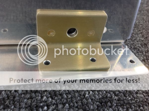

In fabricating and match drilling the Canopy Attach Angles exactly as given in the directions, I discovered that one of the rivet holes ends up providing far less than the usual 1-? diameter minimum edge distance (photo).
I searched the archives and found no mention of this issue. I'd be interested in getting some learned feedback from the brain trust. I also sent an email to the Mothership, but being a holiday, I don't expect to hear back from them immediately.
My thoughts are to re-do the brackets. Easy enough to get some more angle and make one end a bit longer (yeah, ACS is closed today, too). What sayest y'all?
