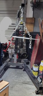

Does anyone have a pic of how they lifted the new Rotax from the shipping crate. I’ve got a cherry picker, but I don’t know the proper way to rig for the lift. I certainly don’t want to damage anything.
I have a 3' web strap with D-ring shackles at each end. Insert the D-rings at each red arrow and loop the middle of the strap through the hook-ring of the cherry picker/engine hoist.
Note: My D-rings needed to have a bit of grinder time done to fit without rubbing anything.

These are the official lifting points.
There are specific Rotax part #'ed lifting adapters that are intended to be used but any sufficiently strong (rated for at least 70 pounds or so) hardware like a shackle mentioned, can be used. Done it quite a few times.
I used one of these:
https://www.harborfreight.com/3-4-quarter-ton-capacity-heavy-duty-load-leveler-67441.html
If you remove the chains from the bar, flip the chains around and bolt them back in place, the d shackles (that previously attached the chains to the bar) are a near perfect fit for the factory lift locations. There is a slight interference with one of the mounting screws for the ignition coil. I temporarily removed this screw while lifting the engine.

Chain with 1/2" all-thread thru a pipe for a spreader. I believe the Rotax manual states to keep the lifting force on the lugs vertical.
