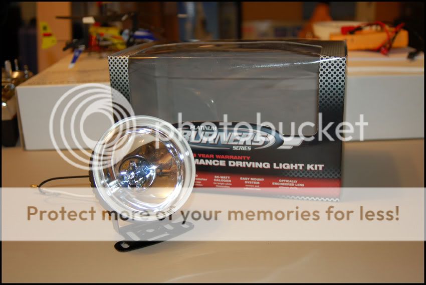

Well, I picked up an HID setup with the intentions of using the current housing setup that is in our plane and the more I looked at it, the more I thought about changing.. However, I had already purchased the HID's with an H3 bulb, so I was somewhat committed to that..
Last night while in the aviation department at Wal-Mart I spotted some driving lights that had H3 bulbs.. $18.97.. Hmmm...
I figured I'd take them home, pull them out of the box and see what I could do with them..
I haven't been able to do much as I'm studying for a checkride I've got later this month, but I did find enough time to rough out my idea for mounting them..
These are the lights I found..

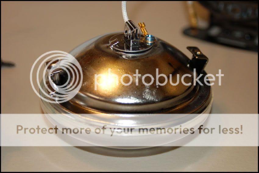

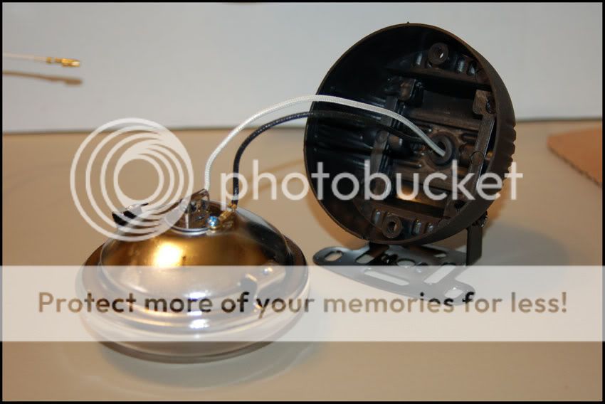

.. and this is what you find if you start taking it apart.. I was looking for the simplest way of mounting them and kept removing parts until I got this far.

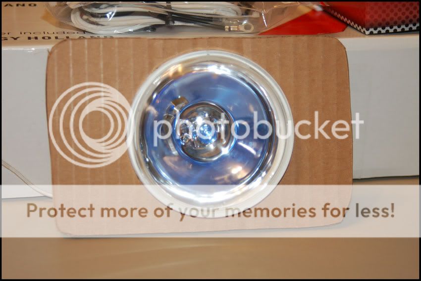

Cut out a quick and dirty mount from the template I made from our current setup.. I like the look..

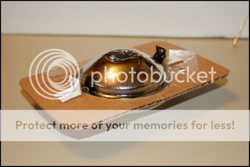

If you look on the edges of the lights, there are bent tabs that the lights will mount to the plastic housing with. I thought I'd see if I could bend these tabs out to be able to use them as a mounting surface..
I'm thinking about just riveting two brackets onto the mounting plate and calling it a day.. To service, the whole unit just pops out and you have direct access to the bulbs.
Obviously this is just a cardboard cutout to see if "what was in my head made sense."
Just thought I'd see what the wiser than me guys thought..
Anyone have any comments?
