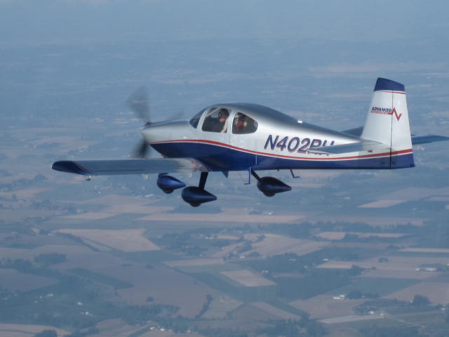

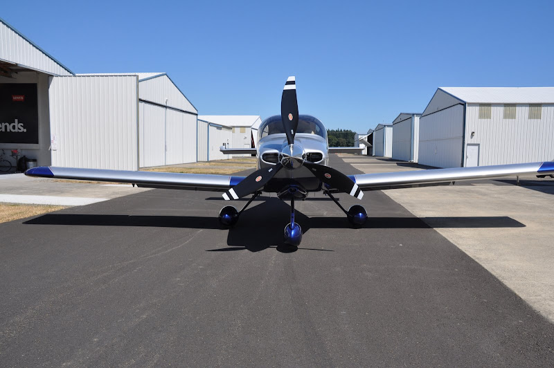

Now that I have all the fairings cleaned up and the plane is finally painted, I decided that it was time to compare its speed with another RV-10. My RV-10 has the Hartzell composite three-blade propeller and in previous comparisons with two other RV-10?s, it was a disappointing 7-9 knots slower. The two previous tests were done before my RV-10 was painted and the fairings had been cleaned up.

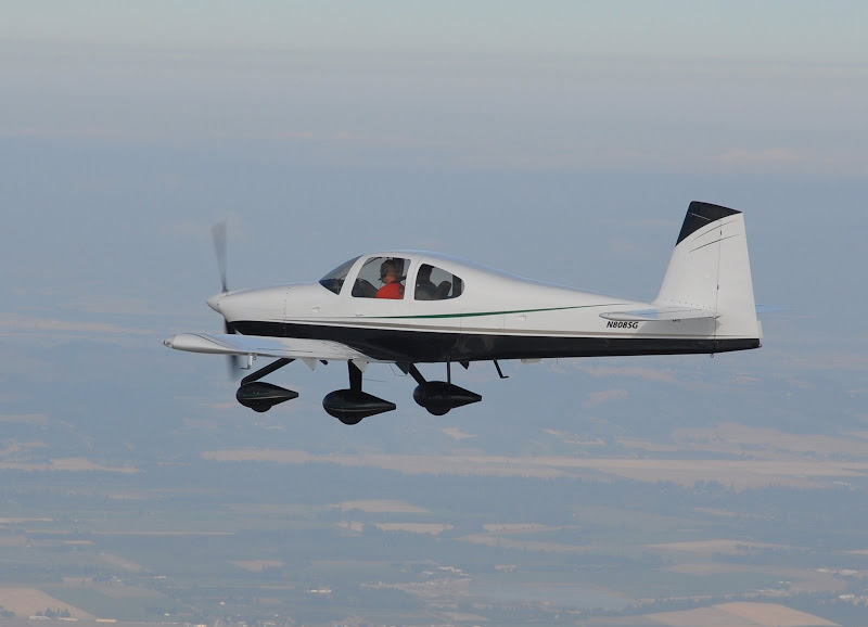

Yesterday, I had the opportunity to fly with Scott Gustafson's painted and very clean RV-10. Scott?s RV-10 has the standard Hartzell Scimitar propeller. We discovered that at 5500ft, 2500 RPM and full throttle, that both planes were going exactly the same speed.
I plan on comparing it with one of the previous RV-10?s later this week to verify the speed improvement. I have been thrilled with the composite propeller. It is extremely smooth and I really like that it can be easily repaired should it ever suffer any damage.

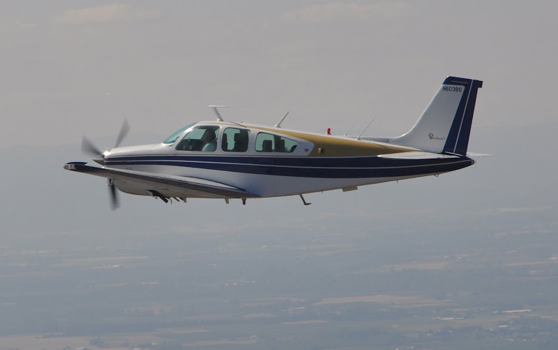

Upon landing, one of my neighbors walked over and proclaimed that it was time for him to show me how much faster his Bonanza F33A was. We took off in formation and climbed up to 5500ft. After flying south for around 10 minutes, we discovered that my RV-10 took around 2 inches less manifold pressure to keep up with his Bonanza (that was running full throttle). We then found that the RV-10 would go 10kts faster at full throttle.
My neighbors Bonanza F33A

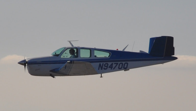

Soon after landing, my OTHER neighbor showed up to discuss the results. He has a V35B Bonanza and everyone knows that the V-tail is faster. Ten minutes later we were taxing out in formation so that I could see how fast a real Bonanza was. We did discover that he was right, the V-tail is faster than the F33A and is only 7-8kts slower than the RV-10, and my plane had "all that gear stuff hanging out?.
Bonanza V35B, photo taking just before going to full throttle.

One of the big advantages with the composite prop that people do not give near enough consideration to is that it is repairable. I have seen nearly new metal props with big filed out areas, with the composite prop you can easily repair it. I know of a SR-22G3 Cirrus that had one of the blade tips damaged when the professional pilot forgot to remove the tow bar before starting the engine, the prop blade was repaired.

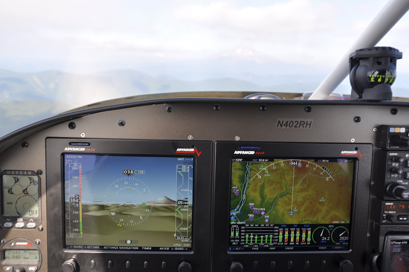

If I were really evil I would ask:

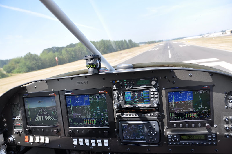

Does your panel show the runways?
Can you see Mount Hood on your EFIS?
Rob Hickman
N402RH
I wanna see the Runway and Mt Hood!!
Rob, do you have your screens in the much slower Bonanzas?.....oops......I guess they will just have to wait for certification!!
I am weighing in to verify that our speeds at the same altitude and power setting were identical. I expected a different outcome but I was not faster.
I can't even say my plane is better looking because both our 10's look fantastic!
Scott Gustafson

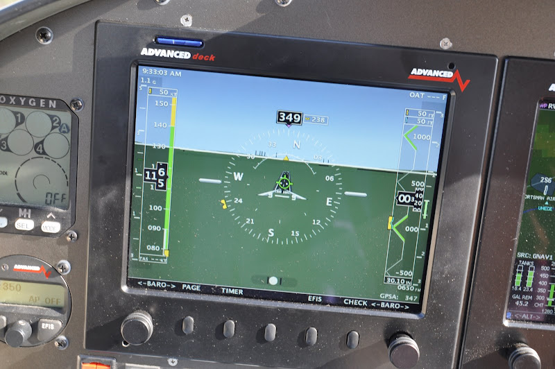

But, lower left corner of this photo?????

You "had me at Hello", Rob. Your EFIS system is at the top of my wish list...I just gotta get those little quackers into line abreast so I can start the build process.

O.K., this thread is about props.
Woah, Peek a bootie! Thanks for pointing that out. Maybe an AFS branded TruTrak A/P with something a little special mixed in?
"But, lower left corner of this photo?????"
That is our Autopilot that TruTrak manufactures for us. It is a special version of the Digiflight II VSGV that communicates with the EFIS. We have been shipping the autopilot for a couple of months.
http://www.advanced-flight-systems.com/Products/AF-pilot/afpilot.html

Hartzell Three Blade Composite Speed
I had the chance to fly with Dan’s RV-10 last night; this is the RV-10 that was previously 8-9kts faster before paint and cleaned up fairings. Dan’s RV-10 with the Hartzell Scimitar prop is now only about 3-4 kts faster. Dan had 25 gallons of fuel (150lbs) and I had 60 gallons (360lbs) and I had my son Brian with me, this makes us around 370lbs heavier. Both RV-10’s were painted by the same person with the same level of finish quality; both have one Lightspeed electronic ignition. Both planes had the same amount of ballast weight in the baggage.
I am now extremely happy with the propeller.

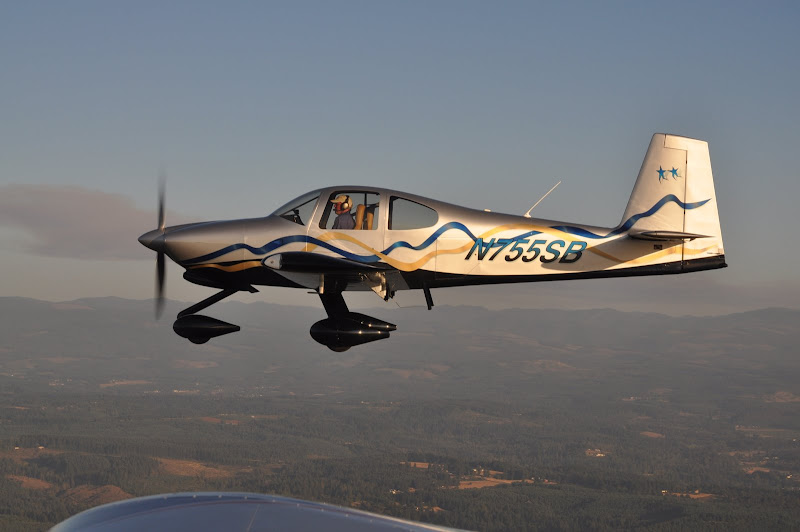

what is the base coat/ color on that RV 10? what is the upper color on your plane? they look pretty similar, a silver color, or even an anodized (hard coat with no dye) aluminum.
Paint Color
I believe that both N402RH and N755SB have the same Silver
Metallic base coat on top: PPG 36570. This color is also used on
late model BMW's.
- Dan Benua
RV-10 N755SB
