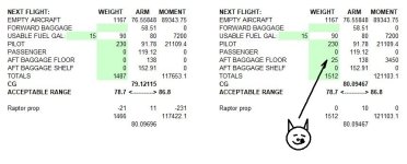

It does make a difference in CG (roughly an inch), but again, the real benefit is reduction of mass moment of inertia. You're installing a smaller gyroscope.
If CG is your only criteria, you can do the same thing with a 25 lb bag of cat food on the rear baggage floor. It's cheaper and the cat will appreciate it.
(I'm guessing at the prop arm, as I'm not at the airport right now.)
