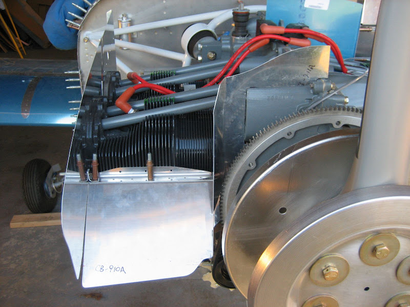

I'm working on the baffles on my o320-h2ad powered 9a. So far I've been pretty happy with how they fit considering the engine is quite a bit different.
I do have a few issues though:
1. I had to add a joggle around the filler tube. Will there be any issues putting the rubber on top at the joggle? Any problems with the oil door opening right on top of the baffle?
2. The baffles don't fit the contour of the engine very well. Would making small filler pieces of aluminum and riveting them on be ok? How close should the metal come to the engine? Fill small gaps with high temp RTV?
3. The edges of the upper engine mounts are pushing in on the baffles slightly. Should I add a double here, or strips of nylon to prevent damage?
All pics here: http://picasaweb.google.com/pilotandy/RV9AH2ADBaffles#
Any help is greatly appreciated!
Hi Andy
Arh...those baffling baffles...I remember the same issues when I fitted the H2AD to my RV6 project. I did it a little different.
1. I did not have a joggle around the oil filler neck. I completely remade that right rear piece so that it was flat and would butt right up against the rear of #3 cylinder.That allowed this piece to lay in front of the engine Boss/casing that is shown in your pic #6&7. I also had to shorten the #3 cylinder end/top plate and bend a 90deg. flange on it to attach to the rear plate. The reason for this is two fold,this fixed the oil door baffle seal problem and also allowed the oil cooler to be mounted on the flat surface right up against the cylinder so it would be clear of the engine mount. The oil filter adapter has the hose fittings facing the right side of the engine so mounting it on the right made sense(same as the c172). I also made a doubler for the end plate and a .061 plate for the cooler opening. Have you given some thought to the oil cooler size and location? I tried the firewall setup from vans with the standard 0320 cooler fitted and run with 3'' scat. This proved totally inadequate so I changed to the larger positec type for the 200hp engine and moved it to the right baffle and oil temp now runs at 185/200 in all weather. I found out latter that the C172n that these engines come from is standard with a SW 599 cooler. The small bracket that you show in pic#3 gets remade from some .061 angle and is fashioned to be riveted on and pick up that open 1/4 hole in the middle of the pic. Also keep in mind that the cutout in the top cowl for the oil door only has to be about half the size as that specified by Vans because the filler neck ends up being about 3/4" below the top cowl and you don't have to reach around inside to top up with oil like the other engine models. If the opening is small enough you should be able to run the baffle seal material in front of the opening.
2. Your fit to the engine contour is ok and as you say a little high temp RTV and they should be fine. The left forward section of baffle will not fit at all so I just riveted a section on to accommodate the different crankcase shape.
3. I had the same issue with the left upper engine mount. I modified that piece so it laid forward a bit and would lay flat against the engine mount boss were the bolt comes through. That left piece is a very tight fit, I also had to notch a section to go around the lower part of the cylinder flange and have to remove the Lord mount nut and bolt enough to remove that part of the baffling. I fitted a 2" scat flange to that piece so I could run air to the cabin heat muff.
I hope you can follow what I mean. I could pull the top cowl and take some pictures for you if you wish?
It took me many hours to figure some of this stuff out at the time so I know what you are going through!!
Wait to you get to the front half!!
Regards
Graham
RV6 H2AD 200hrs

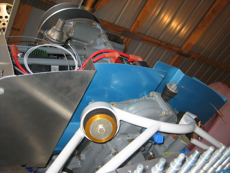

Thanks for the tips Graham. The front is indeed interesting! I'm going to have to reinforce some of the areas where I carved a bunch of material away. Did you go around the mount (I'm assuming governor mount?) on the front like this?
No, you can't go around the governor mount like that. The governor mount as well as the fuel pump are already to high for the top cowl to fit and require cutouts and "bumps" to be glassed on to allow the top cowl to come down to meet the bottom. The only way is to mount that front piece more forward. I made mine in two halves and made brackets that picked up on the bolts/threaded holes in the crankcase parting flange, governor pad & fuel pump to hold it on.
Anyway, they say "a picture is worth a thousand words" so I went to the hanger and took some for you today. Click here http://picasaweb.google.com.au/airtractor8/H2ADBaffles?feat=directlink
Pic #11 shows you what I mean about the gov. pad. There's also some pics of the "bumps" and a shot of the underside cowl showing the mods to the inlet ramps to make it all work .
I hope this stuff helps you out. Its just the way I did it,I'm sure there is others in here that may have done it differently but no ones talking!!
Keep us informed on your progress and feel free to ask more questions. Don't forget to post a few pics of the finished product!
Cheers & Beers
Graham
