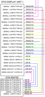

Fabricating a connector and connecting to the GRT Sport EX EFIS is something that should be simple but I really need to see a step by step build log of someone else doing it and could use guidance on what pins I need to populate and what the connectivity should look like.
