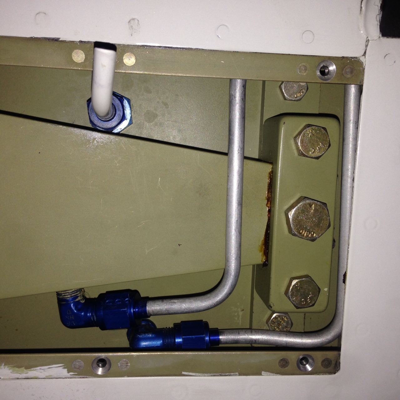

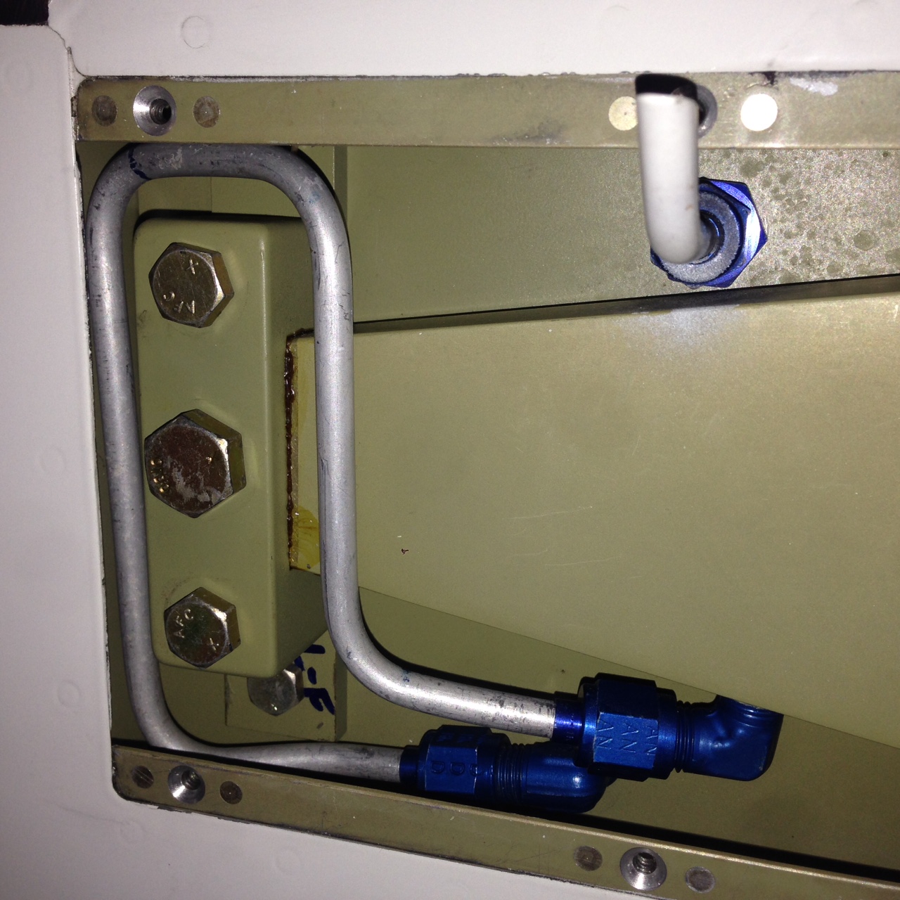

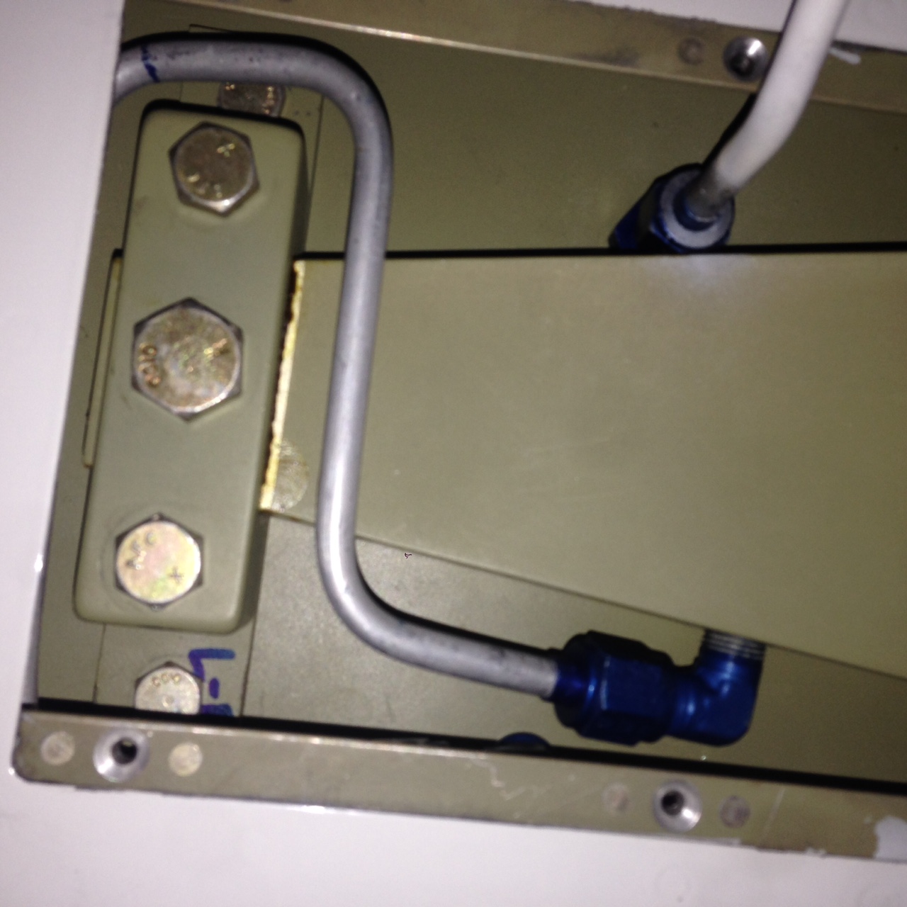

For several years, I've been meaning to post some pictures of how I fabricated the upper brake line plumbing on my Grove aluminum gear legs. My goal when I plumbed them was to use the "stock" bulkhead fitting location inside the gear towers. I finally remembered to snap a few quick pictures during my last annual. There is ample clearance around the lines allthough it may not appear so in the pictures. When these shots were taken, the airframe had about 510 hours on it and there is no evidence of rubbing or leaks Hopefully some future builders will find these helpful.
