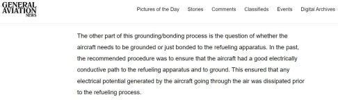

The ground is to dissipate any static that the aircraft has created during flight. So you want to connect to a location that may have a potential source of fuel to create a situation that you are trying to avoid.........:rolleyes:
For the same reason you don't connect the ground jumper to the battery.
Exactly what I was thinking.
Also
No static wicks on most small planes too.
Use the exhaust, it won’t blow you up.
Boomer
Actually, you ground during fueling because the fuel flowing within the pipe or hose can build up a static charge…
A ground is a ground is a ground. You ground during fueling ops so a static spark won't ignite the fuel through the filler port. If you ground to the exhaust you have exhaust gaskets, motor mounts and other "connections" to the fuel tank that may not be so great.
Yes it seems counterintuitive to ground to the actual tank, but did you ever consider how to ground a composite aircraft for fueling? Look it up.
-Marc
Ground your aircraft the way you want. But understand why you are doing it.
And you are willing to bet there will be no arc during the connection.
The ground to the exhaust is a safe and efficient path to the entire airframe.
One grounds their airplane during refueling to eliminate the difference in charge potential between the airplane and fueling apparatuses. If that difference is great enough, whether due to charge buildup from fuel flowing through the hose or the airplane flying through the air, there can be a spark and therefore a fire.
Technically, both reasons are correct; flying through the air can build up a charge AND pumping gas through a hose will build up a charge. In the end, the point is to reduce the static potential and prevent a spark.
a line-boy told me that using the exhaust cold lead to cracking. is this true?
No. Line boy doesn't know what he is talking about. You entire airframe is a ground and passing all sorts of electricity. Following his logic, your plane would have broken to pieces by now.
Cracking.
I think the concern is that if someone makes a scratch in the exhaust stack when yanking off the grounding strap that it could eventually lead to cracking due to thermal cycles. I am no metallurgist but think that thick stainless is not likely to crack but other alloys might. I use the tie down ring as it keeps the bonding wire out of the way of the hose and it is closer to the pump.
Correct. It's the potential difference that can cause the spark, and it could either be from plane to the fuel hose or fuel hose to plane, depending on which has the greater charge. Grounding the airplane provides a path for dissipation of that potential difference, therefore no spark at the airplane/fuel hose interface. Theoretically.
