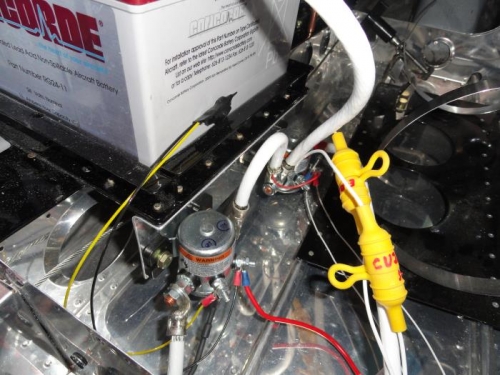

I don't know why you say your master relay can't handle two lugs on one side; every contactor I've seen can easily take two terminal lugs for #2 AWG wire. I'm using the Vertical Power diagram for a ground power receptacle and you can see my unfinished installation below. The master contactor is the farther one; the ground power contactor is the near one. On the near terminal of the master contactor is the jumper from the ground power contactor and also the line from the battery.
I can get a different contactor if need be. The one that Vans sold me will not take two. Between the two nuts and the lock washer I barely have one, maybe two threads showing with just one terminal on it. With two terminals the outer nut hangs off by a thread. I'm toying with running it straight to the battery terminal and if not i'll get a different product.
Thanks all,
Bill
If you can get the nut on all the threads (but none showing) I wouldn't worry about it with the lockwasher.
OR How about deleting the lock washer and using a low-profile, all metal lock nut?
Or possibly find a low-profile backing nut. Anyway, I seem to recall using a Vans-supplied contactor for the RV-6A but these are from Aircraft Spruce because I'm doing a 28V system. The 14V version is part number 11-03161 and costs $25.
