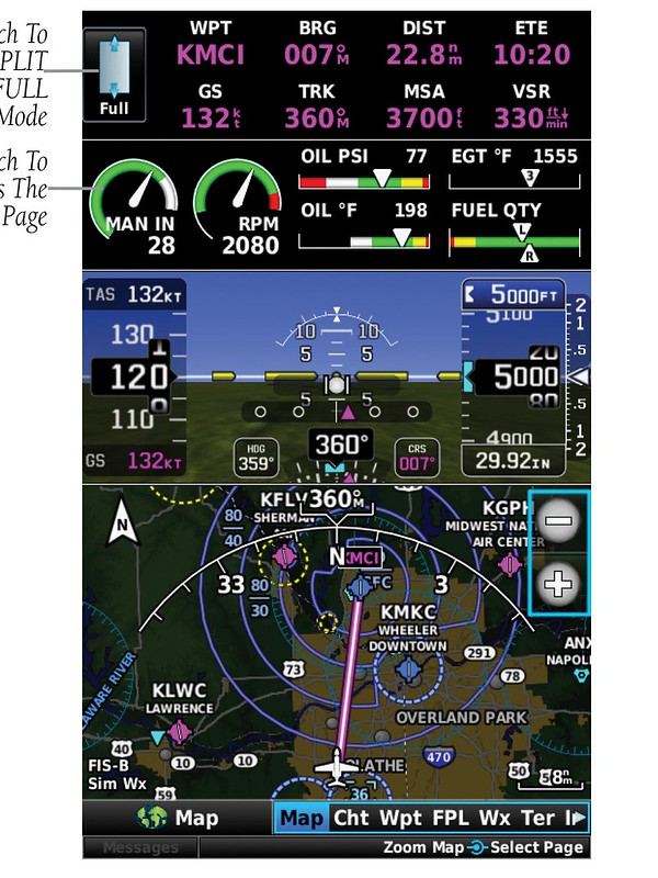

The single GDU 470 PFD has a Split/Full button in the upper left to split the screen and expose the MFD pages including map and flight plan. Meanwhile, the Aera 660 would be a full-time MFD with traffic/weather.
Steve

I think this is what you're looking for. I agree, not easy to find at all.
IMG_1459 by Ed Fleming, on Flickr
As you can see the PFD section is quite compressed, probably why Garmin don't recommend this. The difference with the 370 appears to be in the amount of info displayed across the top of the screen. With a Garmin Comm and transponder in the system, there would also be those fields.
I wonder if engines were displayed in the MFD section, if the engine strip would be removed making more room for the PFD?
In my opinion this single screen would be ok for VFR, but I wouldn't want to fly IFR with it.

Yes Ed, that is what I was looking for. Thank you. Up til now, I did even know if it was possible to display the PFD in split screen with say comm or flight plan, etc.
I agree the PFD in your pic is so compact it would be difficult to realistically use IFR. But, if one were to never display engine data on the GDU 470, it might work.
