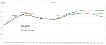

The standard response would be heat soak or vapor lock or whatever, but honestly, I don't see a down side per se. I just didn't feel like there was enough real world benefit to warrant the additional plumbing complexity plus taking up space on an already crowded firewall.
I have zero problem with somebody installing a gascolator if that's what they want to do, but I've been around airplanes for a long time and think that I have a pretty solid knowledge base on which to formulate my opinion. I simply don't believe that a standard size gascolator is going be able to separate out water at the pressure it's being shoved through there for a fuel injected engine.
I'm happy to change my opinion if somebody wants to set up a bench test rig, shove a mix of water and fuel through a gascolator at 25 psi and see what happens.
