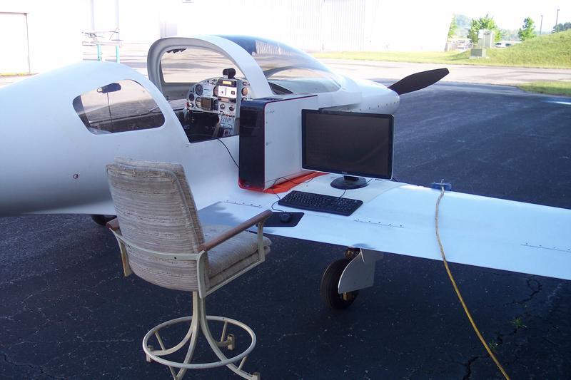

Thanks, Steve. I love my GDL-82. The installation was straightforward, and so was the programming. Did I ever post how I programmed it? We don't need no steenkin' laptops!
