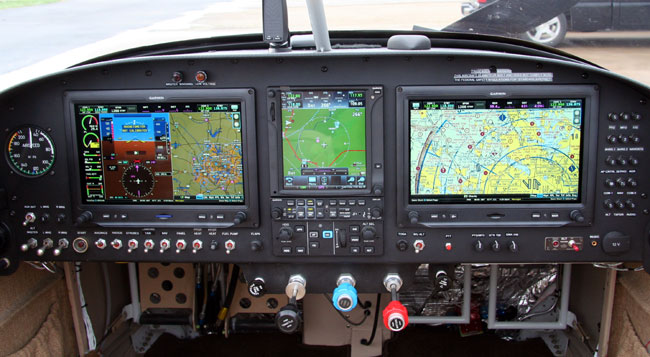

Ricks panel:
The round AS ind had been replaced with a G5
