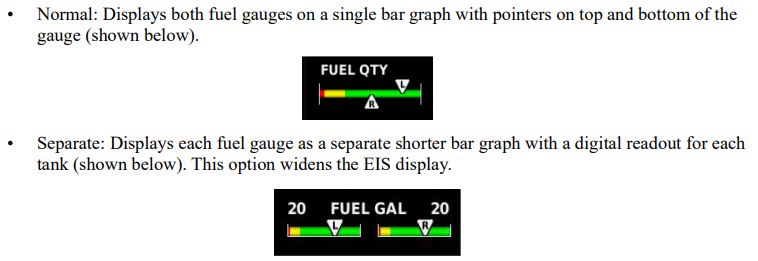

It would be nice if you put the fuel remaining (from totalizer) after the “fuel qty” label. That would free up a data field for me to use for n something else.

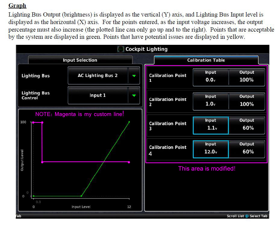

Lighting Bus GRAPH feature
I want to backlight my Annunciator Lights / Push Buttons with one of the GAD27 PWM Lighting Bus outputs.
I am going to controll the avionics backlighting with a single potentiometer.
1. In the pot's OFF position the avionics has authority to use it's own photocell. (DAY operation)
In this position I want the Annunciator lights to use full brightness.
2. As I rotate the pot out of the OFF position and Voltage builds up, the avionic's backlight is now force controlled by the lighting bus input/output.
Once the pot is moved out of the 'DAY' or OFF position (NIGHT ops) I want the Annunciator lights to go to 60% dim.
As I understand from the G3X manual, this is not possible as the green curve can only go up. I would like to be able to set the curve as depicted in magenta:
