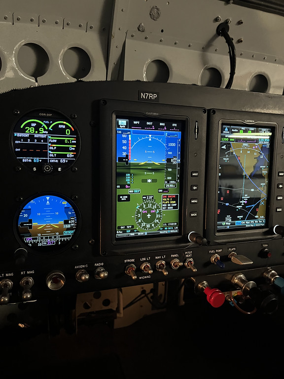

I wish I could have a single GDU with and ADAHRS and select to be either MFD or PFD. Currently it will default to PFD when an ADAHRS is present and will not select to MFD with that setup. I’d love to have a G5 as PFD and GDU as MFD but have the option for selecting PFD if I want.
Thanks Matt, but I have just the plain and standard pitot heat. Hopefully they can add the CAS message for that as well.
You can still get the CAS message today if you have an unused discrete input. You don't even need to add any additional wiring. See "Pitot Temp" in section 29.4.32.26 of the current installation manual (revision AS).
The system doesn't allow you to remove required instruments, so if you have an ADAHRS you have to have a PFD page somewhere. But a system with a G5 and a GDU acting as a full-screen MFD (no ADAHRS) is supported if that's what you want.
No I actually want to be able to do it with the ADAHRS there. So that’s why it is a wish. I already know it doesn’t do what I want.
The reason I want this is to have a g5 as PFD. But if the g5 dies I’d like to have the ADAHRS support the GDU as a PFD. I’m only wanting one GDU.
So a discrete input that allowed Mfd/pfd selection in addition to the current reversion mode select would be my answer.
So a discrete input that allowed MDF/pfd selection in addition to the current reversion mode select would be my answer.
I know you’re talking about being able to use a G5 as a PFD and how that’s not currently possible, but I’m wondering if a GI 275 could be used?
Hi Matt,
This is a great info and thank you for sharing.
Just to clarify, with those who don't have a controller, we can still use an unused discrete which will not require to use a physical wire to connect to any thing, it just uses the discrete logically based on the OAT temp.
Instead of buying a GSU 25 to back up the G5 (and probably never use it), why not just install a second G5 and use it as an HSI when it is not being the backup for the primary G5?
Steve
Good idea. I remembered the other reason I want the ADAHRS is for the AOA display that I like so much. So I have to add to my wish putting the AOA on the G5 or MFD. not likely to happen I think.
