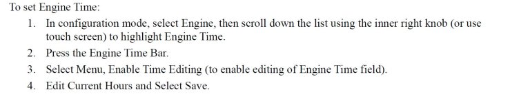

Feature request! It would be nice to be able to manually reset the times to exact numbers. I have a regular hobbs meter on my panel that I like to use for recording my flight hours, but it would be helpful to be able to double check the hobbs with the total time the G3X records (in Oil Pressure mode). Unfortunately my hobbs is persistently about 0.4 hours behind my G3X. Hobbs circuit had a blown fuse for about that amount of time.
Maybe instead I'll apply power to the hobbs for 24 minutes and synchronize them that way.

No problem at all. I would think it's a safe bet that they made editing the time values a little more cumbersome than usual in order to prevent accidental edits from wiping out the aircraft's history. I personally once lost my recorded hours from another brand of EFIS, so I am sensitive to this! So much so that I put a mechanical Hobbs meter in my otherwise high-tech panel. :)
