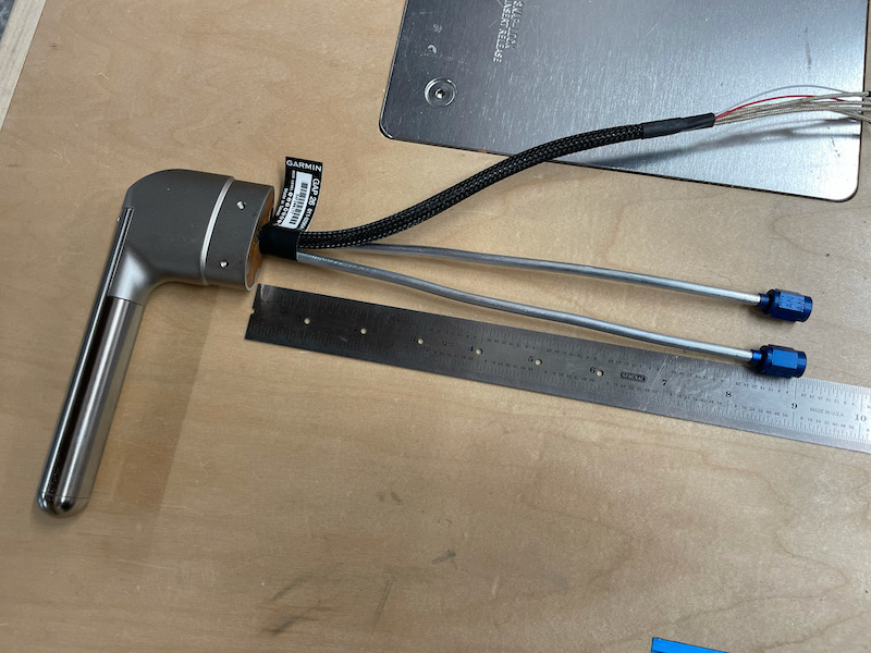

I've seen other builders post pictures of the various ways they handled the plumbing connections for their GAP 26 pitot tube / AOA probe, but I've never seen photos of this exact method, so I thought I'd share in case it helps someone else.

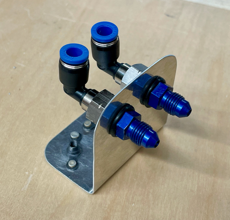

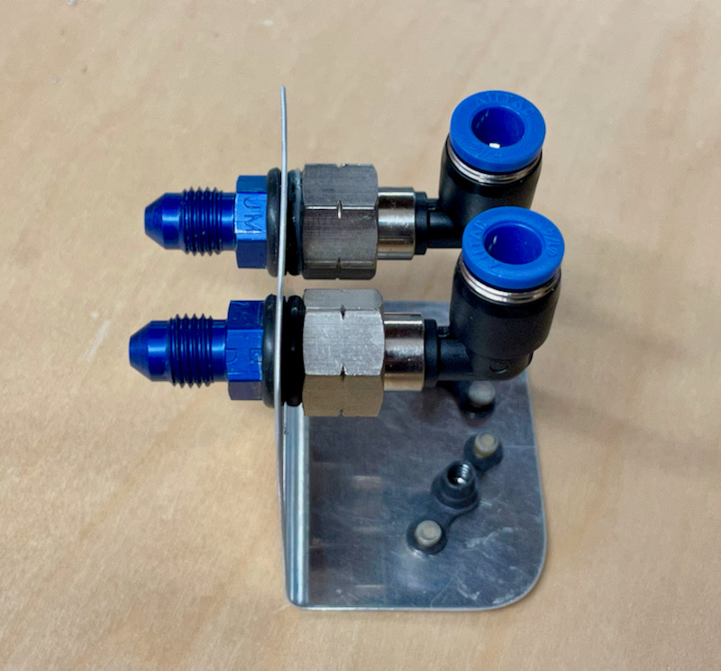

I made this little bracket, which holds a pair of AN816-3D nipples connected to some 90-degree 1/4" push-to-connect air fittings that have female NPT threads:
I sandwiched the bracket between the plumbing components using rubber O-rings to create a bulkhead-fitting effect:

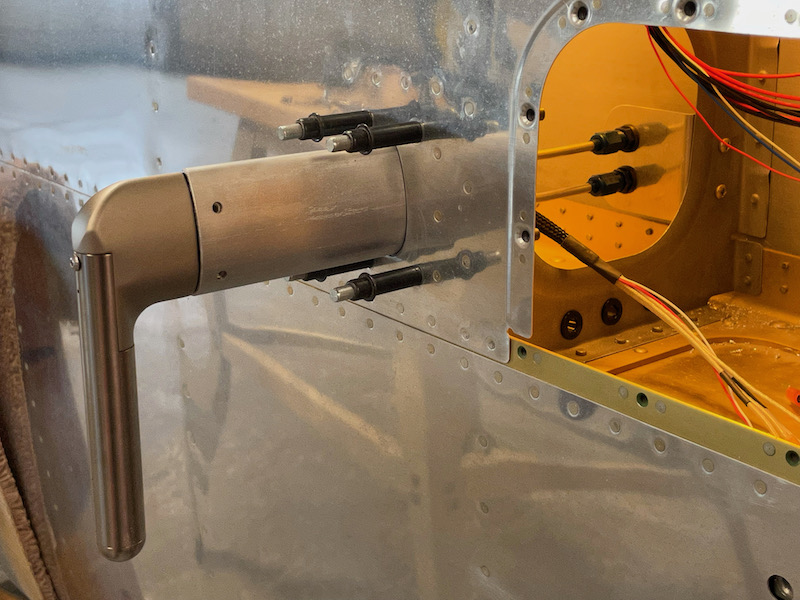

The bracket attaches to the top of a wing rib. The air fittings are on top, with about 1/4" of clearance to the top skin:

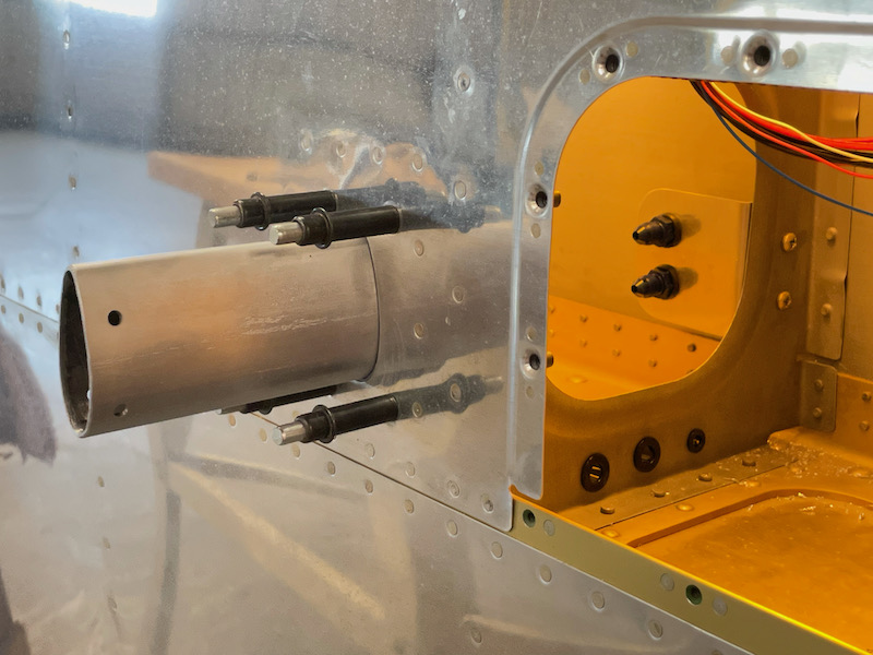

The aluminum tubes from the pitot run straight to the bracket fittings, no complicated bending required. The 90-degree fittings face towards the wingtip, and the 1/4" nylon hose will do a gentle 180 from there and then pass through the snap bushings at the front of the rib:
With this method I ended up with almost 9" of tubing coming out of the pitot (8" is the minimum length specified by the manufacturer).
Not sure if this will work in an RV-9 which I think has a skinnier airfoil, but in my RV-7 it worked like a charm and was way easier than trying to bend the tubes but still allow them to pass through the pitot mast.

The forward tube of the GAP 26 is pitot pressure, aft is AOA pressure. I am using different-colored plastic tubing for each, so that shouldn't be an issue!

Your solution looks great, quick question.
It looks like the cut and flare would have to be absolutely perfect to avoid a gap or misfit between the actual pitot and the mast, how did you do this or is there some play in the fit?
Fred
Good question - I did have to be somewhat careful when cutting the tubing to length, but the bracket that holds the fittings is pretty light-gauge which allowed me to tweak the geometry for a perfect fit. Also if the flared tubing ends up being, say, 1/16" too long it would be easy enough to put a gentle S-bend in it as it comes up the mast, reducing the effective length.
Great post! Could you not have the tubes and bracket assembly all connected and then drill the bracket to rib to get a perfect fit? Also, where did you buy the 90 degree fm NPT X push air connect?
I think you could certainly do it this way if you were installing the pitot plumbing prior to riveting on the bottom wing skin. In my case I was working through the access hole, so it would have been difficult to drill holes for the bracket from the hidden side of the rib. Also, if you ever had to replace the pitot tube for some reason, you'd be in the same boat.
I got mine here, although I had to buy 10. Maybe I'll send this thread to Steinair and suggest they start carrying these fittings.

Yes, this approach works too. If you have a heated pitot, just remember to leave more aluminum tube than Garmin did in their exhibit booth... you need a minimum of 8 inches per section 5.2.1 of the installation manual.
