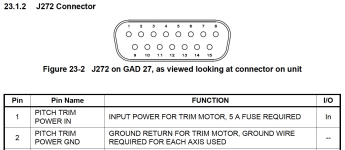

I'm in the process of wiring my panel and all was going well until today. I had planned on having a trim reverse switch on my panel in case of trim runaway to bring the trim back in to a neutral position to ease stick forces. The idea is if the trim is running away, just reverse it towards neutral and then switch it off.
I have a Ray Allen trim motor wired into a GSA 28 AP server for auto-trim. From the servo it goes to the GAD 27 J272 pins 11 & 12 (manual calls these 'Pitch Trim Out 1&2').
From the GAD 27 (J272 pins 1 & 2) it goes to a DPDT ON-OFF-(ON) switch and then from the switch it goes to the Circuit breaker and ground.
So the overall connections are like this...
Battery -> Circuit Breaker -> Trim Rev Switch -> GAD 27 -> GSA 28 AutoPilot Pitch Servo -> RA Trim Servo

With the J272 connector disconnected from the GAD and testing with a multi meter the trim switch works a dream. I can connect the meter to pins 1 & 2 (trim input) of the J272 plug and the voltage from the circuit breaker reverses as expected when the switch is moved from the ON to the momentary ON position.
However, when the connector is attached to the GAD 27 the trim works perfectly only in the ON position. As soon as it is moved to the momentary position the Circuit Breaker trips.
These two pins are not switch inputs, they are the power and ground inputs for the pitch-trim subsystem of the GAD 27. What you're actually doing here is connecting power to the ground pin and ground to the power-supply pin, so it's no wonder your breaker pops. Please don't do this, it's hard on the equipment.
Thanks both, for info connector J271 is for the switch inputs. J272 is a separate 15 pin connector and for trim power in and out.
Reading through the manual in a bit more depth and, having had time to think it through, I can see that the switch should be between the GAD and the autopilot servo to achieve the desired outcome.
As you rightly say, Pins 1 and 2 are power and need the correct polarity. Pins 11 & 12 are outputs and I think these can be reversed as they will simply drive the motor in the opposite direction.
