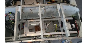

I'm about to install mounts/mounting points for a list of G3X boxes behind the panel of an RV-7:
GAD 27
GAD 29
GDL 51R
GEA 24
GMC 507
GTR 20 (pair)
Should any particular LRU be located in a particular place, or near another, or at the physical end of a wiring harness? All tips welcome. Photos too. No point in re-inventing the wheel.

Dan, I would consider the CAN bus daisy chain to be a starting point. For example if you have the GMU 11 in the back, that's usually a pretty good starting point for the CAN bus. I would sketch your daisy chain to be sure you can follow from LRU to LRU in a logical way and end up at a convenient LRU for termination. The GSA 28s can be problematic depending on where they are. I try to keep the CAN bus daisy chain as short as possible. The rest of the harness generally follows what I planned for the CAN bus.

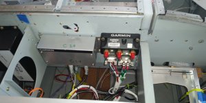

I installed dual GTR 20s recently as shown in the attached photo. I found it convenient to make the tray and install it in the rear near where the antennas where going to be--in this case on the belly aft (obviously not an RV). Having both units side by side helps with the CAN bus and harness as you can go from one to the other quite easily. Keeps the antenna coax leads relatively short as well. And frees up a lot of space behind the panel.
As for LRU placement in general, an important consideration for me is to have plenty of room to access the connectors and to leave room for your hands to get in there to get them on and off. There is a tendency to underestimate the space each LRU needs. I always try to have nutplates on the other side of the LRUs for ease of removal/installation.

I installed dual GTR 20s recently as shown in the attached photo. I found it convenient to make the tray and install it in the rear near where the antennas where going to be...
I had not considered rear mounting for the radios, but again, keeping the coax in the back makes a lot of sense.

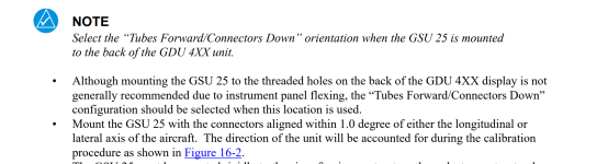

Maybe as a last resort or something to try but here is a clip straight out of the current installation manual.
While it appears Garmin intended on the screen being a good mounting option in the design phase, the real world threw them a curveball and as a result, they have generally not recommended the back of the screen as a first choice for mounting going all the way back to the initial release.

While it appears Garmin intended on the screen being a good mounting option in the design phase, the real world threw them a curveball...
I saw that note in my reading. Based on the wording and what I've learned here (thanks guys!), my take is some panels are too shakey.

Rails and access panels
I used rails to mount my VPX and Transponder. I also have access panels on both sides of the foreskin for easy access. These are trial placement pictures but I basically kept it the same. I did mount my ADHRS in the tail area as suggested at the time (2016) and it has worked fine for me. I have not had to use the access panels but really glad they are there.

My goals for the avionics layout were to make LRU removal as easy as possible, and to provide some flexibility to change avionics in the future. My solution for that was to create a tray that's suspended from the tip-up panel support ribs; the center rib has an additional drop-down support. There were some gotchas but works reasonably well, and before someone calls me on it, yes, it adds a pound or so. :)
Two of the gotchas...regardless of the mounting approach, make sure the connector shell, coax connectors and cable loop are accounted for when you place your LRUs. My transponder (GTX-45R) mounting location left barely enough room for those connections. And as others have said, choose and locate your fasteners carefully. Some of my attach locations are close to being blind and I used hex-head #8 screws (NAS1801, IIRC) so I didn't have to get a screwdriver into some tight spots.
Link to the build site page that covers what I did - https://mightyrv.com/?p=3790.
HTH
Dave

GSU Mounting Requirements
I'm glad I potentially saved a lot of time by mounting it there in the first place.
The guidance against mounting it on the GDU has never made sense, in light of the fact that the GDU enclosure is machined with a nice flat mounting location with holes already tapped to receive the bolts Garmin ships with the GSU, and, if you use the facility they've clearly invested design effort to provide, you don't have to solve as many problems around space and cabling.
It also helps that if you're doing a retrofit panel conversion, the pitot and static lines you need are already routed to the back of the GDU, because that's where your six-pack used to be! Everything's easier.
For me, at least, it's worked there from day 1, and I've never regretted ignoring Garmin's installation advice regarding this one item.
There are a lot more G3X Touch systems in the field than there were when they wrote that advice. Perhaps they should update it. Or, at the very least, explain it.
- mark
Hi Mark,
The responses in this thread illustrate the heart of the issue fairly well, there have been mixed results with mounting the GSU 25 to the rear of the GDU 46X Display. A significant variable in the success of a GDU mounted GSU 25 is the strength of the instrument panel, with less substantial panels providing too much flex to serve as a sufficient ADAHRS mounting location.
While we generally do not advise mounting the GSU 25 to the back of the display it is not disallowed and does work well in some installations. In my experience it is a rare occasion that a GDU mount works better than a subpanel mount, but I understand the frustration involved in reaching that conclusion, which typically requires coordination with our support group to reach.
The instructions provided in the installation materials provide a good general path for success in mounting these units, that work well for most aircraft. Two important pieces of guidance from that section, relating to choosing a good location, are:
  • The GSU 25 must be mounted rigidly to the aircraft primary structure through strong structural members capable of supporting substantial loads
  • Avoid placing the GSU 25 near sources of vibration or audible noise.
Of course there is an inherently high level of vibration in our aircraft, but different mounting locations transfer more or less of that vibration, to the housing of the ADAHRS unit. We have seen a lot of success with subpanel mounted ADAHRS unit, but of course there are exceptions, and sometimes a bit of trial and error is required.
It is important to meet compliance with the other guidance provided in that section as well.
Justin
