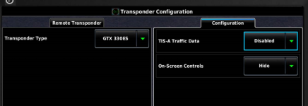

I recommend you disable GTX 330ES provided TIS-A traffic as it is very low value compared to ADS-B traffic. You never want your G3X Touch system to use TIS-A traffic over ADS-B traffic.

If you disable TIS-A traffic you will not see transponder only aircraft or aircraft with a inop ADSB out. That is probably a small percent of current traffic but you will be blind to those aircraft in areas with radar coverage.
That is incorrect.
ADS-B ground stations uplink TIS-B traffic (transponder equipped non-ADS-B Out aircraft in radar coverage) so those of us with ADS-B traffic receivers can see those aircraft.
Aircraft which show up as traffic on the map with no Flight ID are TIS-B aircraft which have been uplinked by ground stations.
Dual frequency Garmin ADS-B receivers (all of them) see all ADS-B Out equipped targets directly with no ground station support. No ADS-R help needed.

...You never want your G3X Touch system to use TIS-A traffic over ADS-B traffic...
Steve,
Completely agree.
However, I can see where/how to turn off TIS-A (GTX 330ES RS-232 Output - "Remote + TIS-A") but no option for the G3X to prioritize it or display it at all...I'm missing the easter-egg...

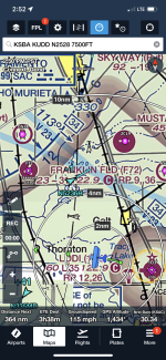

Yes, I have run the PAPR reports a couple times because I had traffic disappearing across the board and assumed that was an FAA issue. However, the problem discussed here is different. The GDL is receiving ground based traffic data and is successfully sending that traffic data to both the Ipad and the G3X for display. When the problem occurs, the ipad successfully shows the air to air and the ground based traffic, but the G3X does not; only the air to air traffic. Either the SW in the MFD is losing it's way or the SW in the GDL is successfully formatting it for the ipad but not for the G3X. If this were related to the client %age, both the ipad and the G3X would lose the traffic and I ahve confirmed several times, that the ipad shows traffic that the G3X does not. In theory anyways.
I suppose it is possible that there is some type of error in the format that foreflight successfully ignores, but the G3X does not. When this problem occurs, the traffic info page in the g3x indicates that it is no longer receiving ground based traffic (box turns from white to grey) even though I have 4 bars of receiving strength and the G3X is seeing 10+ ground stations. Didn't write the SW, so don't know what triggers that change.
Larry
Maybe - Possibly?
Here's a screen grab of what I was seeing -- Note, my setup is totally different, so this may/may not be a similar issue. I have dual G3x Touch, GTN 650xi, and a GTX 345. The GTX 345 is the primary receiver/interrogator/aggregator for ALL data services - TIS, FIS, ADSBxx.
The first symptom I noticed was the total lack of traffic in/around me BUT I could get a visual on them -- then I noticed the "White X" on the Little Tower Icon.
And Behold -- TIS-B Traffic Data was "No Service"
But I was receiving FIS-B weather and the Ground Uplink Signal was strong (4 bars). As I understand it, FIS-B (weather, etc.) is received on 978MHz and TIS-B is received on 1090MHZ and 978MHZ. The GTX 345 is a Dual Link receiver as is the GDL 39R, GDL 5xR.
...and here's the excerpt of the root cause from the FAA ADSB project office:
After receiving several independent pilot reports (and the associated details), we were able to determine that a recent ADS-B maintenance action caused a software anomaly that resulted in unreliable delivery of TIS-B “Service Status” messages in the region where you were flying. The avionics would then interpret the lack of the TIS-B Service Status message as the TIS-B Service being unavailable. However, the TIS-B Targets were still being sent by the ADS-B system and received by the avionics. The ADS-B maintenance procedures have been modified to eliminate the anomaly in the future.
